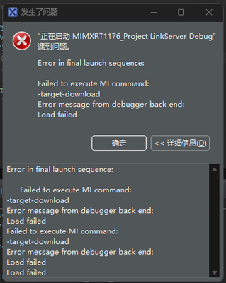

Hi all,
When download the program with rt1170 demo board, I notice log print :
Opening flash driver MIMXRT1170_SFDP_QSPI.cfx
Sending VECTRESET to run flash driver
Flash variant 'iMXRT1170_SFDP_FlexSPI1_A_QSPI Dec 12 2023 17:27:24' detected (16MB = 256*64K at 0x30000000)
 Does this mean that the code download size is only 16MB?

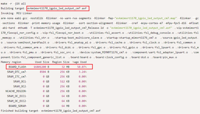

  • Step1: Mocking a oversize binary(e.g, the origin default maximum size is 16MB because of current h/w), I modified example code(gpio_led_output) as below (4 lines added)
// evkmimxrt1170_igpio_led_output_cm7, source/gpio_led_output.c
 * @brief Main function
+ const char largeArray[16 * 1024 * 1024] = {0x01};
int main(void)
    /* Define the init structure for the output LED pin*/
    gpio_pin_config_t led_config = {kGPIO_DigitalOutput, 0, kGPIO_NoIntmode};
    /* Board pin, clock, debug console init */
    BOARD_ConfigMPU();
    BOARD_InitPins();
    BOARD_BootClockRUN();
    BOARD_InitDebugConsole();
+   volatile uint32_t sum = 0;
+   for (int i = 0; i < sizeof(largeArray); i++){
+   	sum += largeArray[i];
    /* Print a note to terminal. */
    PRINTF("\r\n GPIO Driver example\r\n");
    PRINTF("\r\n The LED is blinking.\r\n");
  • Step2, use the new upgrade flashloader and enlarge flash size(e.g 32MB)
  • Step3, building as below log, the flash size(16801200 B) is over 16MB.
  • Step4, Flashing the binary via debuger(e.g CMSIS-DAP), the writing Flash successfully in front of 16MB(1048576 bytes * 16 times = 16,777,216B ), the left size is 23984 B(16801200 - 16777216) failed ( 0x3100 0000 which is over the actual h/w flash size 16MB), But the new flashloader works well.
References from attchment.
  • flashloader algo: MIMXRT1170_Sam32M_QSPI.cfx
  • example of oversize binary: evkmimxrt1170_igpio_led_output_cm7.axf
  • build.log
  • flash.log
Have a nice day!

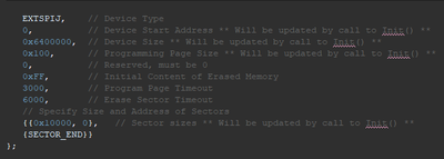

Hi @pupu_ji
Thanks for your question, please see my comments below:
Q1: "Does this mean that the code download size is only 16MB? If my executable file exceeds 16MB, may be 86MB,do I have to modify this parameter in the flashdriver?"
Sam: Yes, it depens on the flash algo, flash driver and h/w flash type.
Q2: And how can i change it?
Sam: You have to upgrade it, the flash algo project is open source(C:\nxp\MCUXpressoIDE_11.9.1_2170\ide\LinkServer\Examples\Flashdrivers\NXP\iMXRT\xxx.zip), please unzip and copy to dedicated folder, then build binary after modify this key parameter(iMXRT117x_FlexSPI_SFDP\iMXRT117x_FlexSPI_SFDP\flashdriver\FlashDev.c) as below
0x1000000, // Device Size ** Will be updated by call to Init() **
which means: 0x1000 000 1024 1024 = 16MB.
   EXTSPIJ,    // Device Type
   0,          // Device Start Address ** Will be updated by call to Init() **
   0x100,      // Programming Page Size ** Will be updated by call to Init() **
   0,          // Reserved, must be 0
   0xFF,       // Initial Content of Erased Memory
   3000,       // Program Page Timeout
   6000,       // Erase Sector Timeout
   // Specify Size and Address of Sectors
   {{0x10000, 0},   // Sector sizes ** Will be updated by call to Init() **
   {SECTOR_END}}
You need to updated the flash algo(xxxx.cfx), please see this reference link for more details:  https://www.cnblogs.com/henjay724/p/14190485.html
Have a nice day!
Sam

pupu_ji
Thank you for your reply.
I also tried to compile .CXF according to this method
https://community.nxp.com/t5/i-MX-RT-Knowledge-Base/How-to-create-a-new-Flash-driver-of-the-MCUXPres...
It realy has modifications in the file
but seems still 16MB...
Is there something wrong with my operation?
thank you
