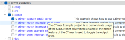

is there any example available for flexPWM input capture?

Hello @embedabu
Thanks for your question.
There isn't a capture demo based on FlexPWM. However, there's a CTimer capture demo under the SDK that you can refer to.
Please pay attention use SDK v25.06
Thank you.
