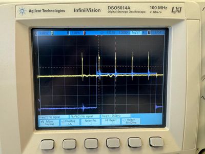

OrenP
attached is the output, where yellow is the expected PWM output, and the purple is toggled every time the interrupt is triggered (it does not happen again after the 2 toggles that are shown in the picture, and the PWM continues indefinitely without any changes)

Zhiming_Liu
The interrupt process is not suitable for the HighFrequencyClock scenario, you can try kPWM_PeripheralClock using 24MHz as clock source.
