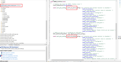

I think you can first test the sctimer sample pwm example.
If it can work, i think you can port it to your demo.
Harry
It also uses the pin 1_22 and pin 1_23.
