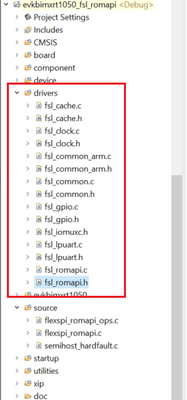

Gavin_Jia
Hi @rantonetti ,
Thanks for your interest in NXP MIMXRT series!
Do you mean you are looking for the fsl_romapi.h file? It located in the driver folder. Please try to test the romapi demo in SDK.
Gavin
