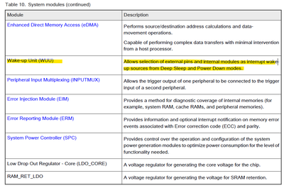

From Table 89 in Chapter 18 (CMC), it seems that wake from Deep Sleep should be possible from any enabled interrupts via the NVIC (and that the WUU is only used by Power Down and Deep Power Down):
However, Table 10 in Chapter 2 of the Reference Manual implies that the WUU is used for waking from Deep Sleep modes
Furthermore, I see that in the "How to implement low power on MCXA153" demo available on the Application Code Hub, that even Deep Sleep mode uses the WUU.
Can you clarify whether the WUU is necessary for waking from Deep Sleep?

So, a possibly dumb question: In order to serve as a wake-up source, is it necessary for a module to remain clocked? If so, then it seems I will not be able to achieve my goal of silencing all clocks.
From the Reference Manual, 23.3.3 Deep Sleep mode (pg 670):
Some modules can remain operational with low power asynchronous clock sources and serve as wake-up sources.
So it seems I either need to clock the WUU and use it to wake the unit. (In that case, I don't think a UART Rx edge can be used, as none of the LPUART signals are listed in Table 84, Wakeup Source for WUU inputs). Alternatively, I need to clock a module itself (e.g. clock the LPUART either from an asynchronous clock source or the LPO CLK16K0) if I wish to use it as a wake-up source during low power operation. Is this accurate?

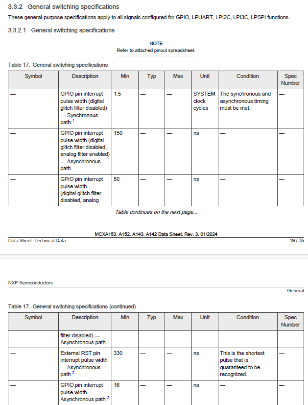

Some further research:
The MCXA153 data sheet does seem to imply that asynchronous edge interrupts are possible on both GPIO and LPUART. See Table 17 in 3.3.2 General switching specifications
I'm assuming that asynchronous means "un-clocked". Is that the case? If so, what is the proper way to ensure that an asynchronous edge on LPUART Rx (or GPIO) can wake the processor from Deep Sleep? Can you point me to example code?
12,590 Views
aberger
Contributor V
How is the "asynchronous path" chosen as the interrupt source? I cannot find it in the GPIO or PORT config.
Finally, what is the difference between the 50 ns GPIO pin interrupt pulse width (digital filter disabled, analog filter disabled) - Asynchronous path and the 16 ns GPIO pin interrupt pulse width - Asynchronous path?

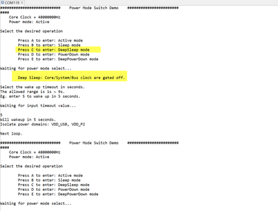

Hello @aberger
I strongly recommend refer to "power_mode_switch_ii" under SDK demo.
The demo prints the power mode menu through the debug console, where the users can set the MCU to a specific power modes. Users can also select the wake-up source by following the debug console prompts. The purpose of this demo is to show how to switch between different power modes, and how to configure a wake-up source and wakeup the MCU from low power modes. Deep Sleep: Core clock, system clock, and bus clock are all OFF, some modules can remain operational with low power asynchronous clock source(OSC32k or FRO16K which located in VBAT domain) and serve as wake-up sources.
This demo demonstrates 2 wake-up sources: - LPTMR: Located in System power domain, clocked by FRO16K which from VBAT domain.
When runt the demo, input C enter Deepsleep mode.
Then you can configure LPUART using FRO16k clock source.
Alice

Hello @aberger
For the Power mode switch demo, I disabled  WUU interrupt , still can wakeup from deep sleep mode. Comment out the code as below:
