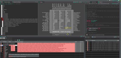

I'm trying to use the USDHC periphepal in the MCXN947VNL microcontroller, but the Pin Config tools displays errors when I change the package from MCXN947VDL (184 pins) to MCXN947VNL (100 pins). Do you know if there is support for this periphepal in ConfigsTool?
  • Also I tried running an example from the SDK in a FRDM-MCXN947, but it works fine on that board. The problem just shows when I switch the uC package
I tried with the latest sdk (v2.16.100 and 2.16.0) but it always shows the same error. Also I'm using MCUXpresso v11.10.0 - MacOs
If there is not support for this, can you please share if there is a guide to setup the peripheral?

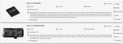

Can you share me which versions of MCUXpresso and MCXN SDK are you using in your setup?
Actually I'm using this ones (SDK 2.16.100-MCXNxx and the SDK of the FRDM board)
2,314 Views
Harry_Zhang
Hi @JoseTepetla
My SDK version is also SDK 2.16.100-MCXNxx,
And my versions of MCUXpresso is MCUXpresso IDE v11.9.1_2170.

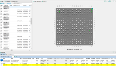

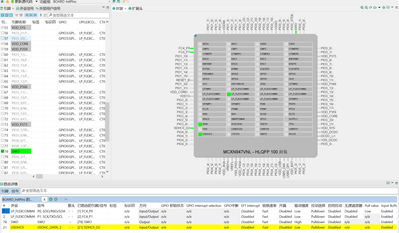

I try to reproduce this issue.
HangZhang_0-1728465253451.pngHangZhang_0-1728465253451.pngHangZhang_1-1728465274950.pngHangZhang_1-1728465274950.png
But when i change the package from MCXN947VNL (100 pins) to  MCXN947VDL (184 pins).
It did not report how the error occurred.
Hang

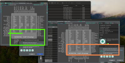

JoseTepetla
@Harry_Zhang
I installed both versions of MCUConfigsTools (v15.1 and v16.1), in the latest one I can't find the USDHC peripheral. Do you know if there will not be more support for the latest version of the tools?
