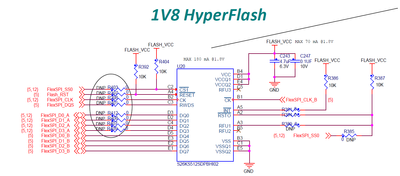

For the mcxn947, there is currently no demo related to S26KL128SDABHI020.
But you can refer to the evkbimx1060 flexspi hyperflash demo.
For  the MIMXRT1060-EVKB, it connected to the hyperflash  S26KS512SDPBHI020.

Although both platforms use FlexSPI and HyperBus,
Clocking and Pin mux are the most significant changes.
There are no major changes in deviceconfig , LUT and main.
