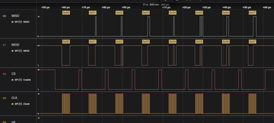

Objective : Board to Board SPI Communication
I am using SDK examples
frdmmcxc242_spi_polling_b2b_transfer_master
frdmmcxc242_spi_polling_b2b_transfer_slave

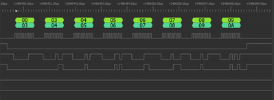

By default in this examples SPI Slave Select is configured automatic. Example is working fine. Please see the attached snashot of logic analyzer.
However When I am driving the Chip Select manually, I observe that Slave data on MISO line is delayed by 1 byte and there is a data mismatch. Hence example is not working. Attached snapshot.
Kindly help to resolve this issue.

I think this situation is because the slave MISO sent an extra data 0. I did an experiment: even if the initial data is changed to 3 instead of 0, the slave MISO still sends an extra data 0.
And I think that the occurrence of this delay is normal. You can just remove the first data of the slave, and then there will be no problem.

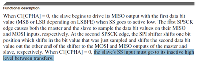

I was able to identify the root cause of the issue. The problem is located in the master project. It appears to be related to the CPHA configuration. As stated in Section 35.5.7, "SPI Clock Formats," of the Reference Manual, when CPHA is set to 0, the chip select (CS) line must remain idle between transfers.
Due to this requirement, modifying the chip select mode alters the behavior of the MCXC242.

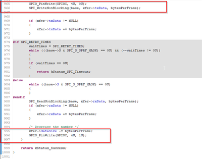

To address this, you can update your code as follows:
Remove the lines:
GPIO_PinWrite(GPIOC, 4U, 0U);
GPIO_PinWrite(GPIOC, 4U, 1U);
from the main function, and instead, place them within the SPI_MasterTransferBlocking function located in the fsl_spi.c file.
This modification will ensure proper data transmission, as the chip select line will now behave according to the timing requirements specified for CPHA = 0.
