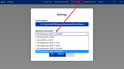

I have trained a very simple model, see in the attachment and I tested them on PC webcam which works perfectly. Then I convert it to FRDM-MCXN947 but then it seems the normalization isnt correct. The result always show something wrong. I am using the Neutron converter version MCUXpresso SDK2.14.0 because going higher it says the version does not match. Could you assist me? Thanks!

Sherlock987
thanks for your quick reply. So I have tested with MCUXpresso SDK 2.16 and 2.15.004 which says the version does not match. With version 2.14.0 I was able to use the model but the image classification isnt detecting correctly. I will also try 2.13.1

Hi @Sherlock987
You can click settings to select the version you need.
