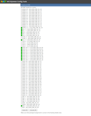

Hello team
Im using W9825G6KH with MIMXRT1176, and I couldn't find 2 signals from the memory named (LDQM, UDQM) to be routed with MIMXRT1176 . If you see the picture below from MCUXpresso config tools, there are no similar names so I can match with the memory. Could you help please. Thanks ahead for your support

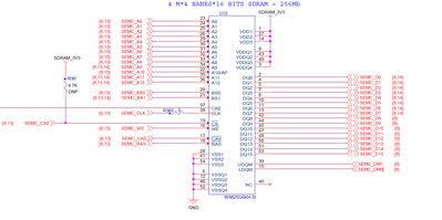

Hi @Engineer_xxx ,
It is SEMC_DMx signal. Please refer to the EVK/EVKB schematic.
Gavin
