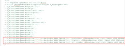

I have a question for put the ML model into MCXN947 based on frdmmcxn947_tflm_cifar10 project. The following is my model and operator which I used.
s_microOpResolver.AddShape();
s_microOpResolver.AddStridedSlice();
s_microOpResolver.AddPack();
s_microOpResolver.AddFill();
s_microOpResolver.AddCustom(tflite::GetString_NEUTRON_GRAPH(),
tflite::Register_NEUTRON_GRAPH());
Both LSTM model and LSTM model which converted to TFLite for Neutron cannot initial model on this project, the following is the error log,  "Failed to get registration from op code CUSTOM"

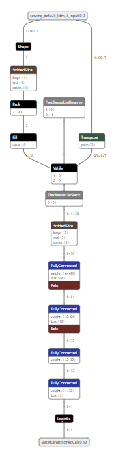

First of all, thanks for your reply. I use a kind of LSTM model to test. I already put my model on the post, what kind of detail information you want?

The model image you provided is not clear, and I am unable to obtain some important information from it. Could you please provide me with the model file and a clearer, more comprehensive image?
Regarding the error report, it appears that the model contains an operator named "CUSTOM," which is not registered in the eIQ examples. The "CUSTOM" operator indicates that it is a custom-defined operator, or that it should be omitted. Including unregistered operators in the model, especially custom "CUSTOM" operators, will result in an error because they must be implemented by the user themselves. It is essential to avoid including such operators in the final converted model whenever possible.

I looked at your model operators via eIQ and they are different from the ones you provided, there are custom operators you didn't include, so it reported the error you mentioned. Also, it turns out that these three custom operators are not supported in TensorFlow Lite Micro.
FLEX_TENSOR_LIST_RESERVE(), FLEX_TENSOR_LIST_STACK(), and FLEX_TENSOR_LIST_SET_ITEM() are specific operators in the TensorFlow Lite Flex delegate that are used to handle tensor list ( Tensor List) specific operations.TensorFlow Lite Micro does not include a Flex delegate or similar extension mechanism and does not support these three operators.
TensorFlow Lite Micro is a lightweight machine learning library designed for resource-constrained embedded devices such as MCUs. If you need to handle tensor list-like functionality in the TensorFlow Lite Micro environment, avoid complex data structures that require these specific operators when designing your model.
