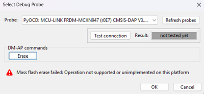

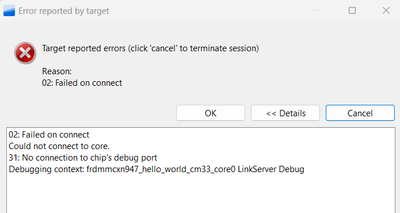

       I'm having troubles with FRDM-MCXN947 development board. The board is unable to connect to chip's debug port making it difficult to erase or flash new FW.
       I was able to use the board for some time and ran couple of examples without issues but recently it starting giving issues while trying to debug.
      I tried to follow some earlier post about the same issue on FRDM-MCXN947 but it didn't help to fix it.
      If anyone can provide me with some inputs on how to fix this issue then it will be helpful.

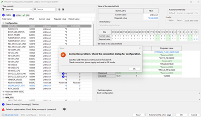

nxpsachve
Hi Alice,
Thanks for your response.
I tried your suggestion but unfortunately it didn't work.
I saw an error message while doing it.

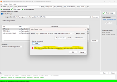

nxpsachve
Hello Alice,
     I'm still facing connectivity issue while using secure provisioning tool as shown below.
Sach

nxpsachve
Hi Alice,
       I tried again after setting my board to ISP mode and was able to follow your video.
       But when tried to Erase it end up with issue.
Sach

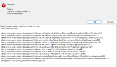

nxpsachve
Hi Alice,
      Here are the details.
      Actually, now I' unable to get any dbg port on the provision tool as shown in video"
Sach
