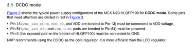

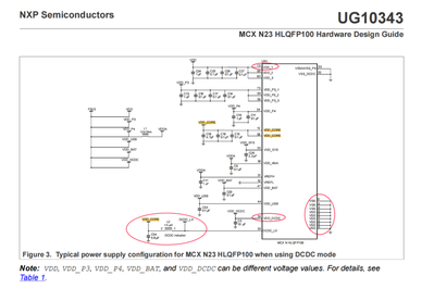

I have reviewed your question. Regarding the HLQFP 100-pin package, Pin 13 (VDD_LDO_CORE, VDD_P2, and VDD are bonded to Pin 13) must be connected to the VDD voltage.
I recommend that you directly refer to UG10343. Although it is written for the MCXN23x, the same applies to MCXN94/54x.
For DCDC mode, please refer to "section 3.1 DCDC mode "

Regarding UG10343, this datasheet is more detailed than UG10092 on the usage of the DCDC converter of the μCU and it shows clearly that VDD is tied internally to VDD_P2 and VDD_LDO_CORE.
I verified that this is the case also in our system, since I lifted pin 13 of MCXN947VKLT (100HQLFP package) from the PCB, therefore disconnecting VDD_LDO_CORE from VDD_CORE and I can measure 3V3 on it directly. After doing this the μCU works fine, so I will correct the design mistake in the next iteration.

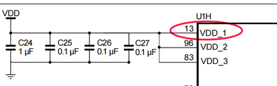

The thing I forgot to ask for the next design iteration in my previous post is whether pin 13 has to always be connected to VDD?
Is a decoupling capacitor also needed?
->> Yes, pin 13 should always be connected to VDD. Please also add decoupling capacitors: one 1 µF capacitor and three 0.1 µF capacitors, as shown in the diagram below.
Let me explain: The note " VDD_LDO_CORE is internally bonded to VDD in the HLQFP package." in UG10092 means that VDD_LDO_CORE is boned to VDD pin, therefore, it must be connected to the VDD supply.

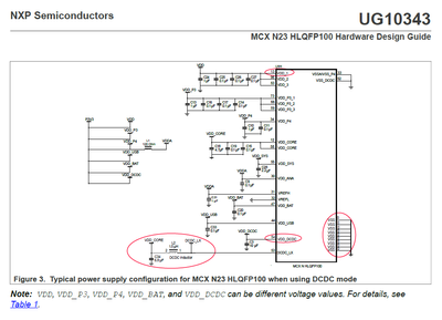

Vasilis_Skr
Hey @Celeste_Liu
I think mentioning more adding the following pictures from UG10343 to UG10092 will help other designers have a clearer picture on what to do with the pins :).
Thanks a lot for your help!
