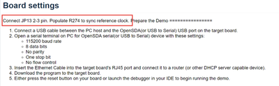

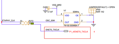

Joey_z
hi,Vagni
Thank you for your interest in NXP Semiconductor products and the opportunity to serve you, I will gladly help you with this.
View schematic SCH-55277.pdf as shown below. If you want to use ENET0_TXCLK, try Connect JP13 2-3 pin. Populate R274 to sync reference clock, close JP50.
Wish it helps you.
If you still have question about it,please kindly let me know.
Xu Zhang

Vagni
Thank you Xu Zhang,
Yes, I have JP13 closed on 2-3 pin, R274 populated and JP50 closed.
Are my above assertions (ENETRMIICLKSEL = 1, PLL0 clock 150MHz ; ENETRMIICLKDIV = 2, divide by 3) right to output the 50MHz clock from ENET0_TXCLK? I miss something else?
With the original assertion (ENETRMIICLKSEL = 0, no clock) and JP50 open it works properly.
