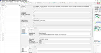

I am using the MCXA153 chip for a project and I have 5 ADC inputs. I do not have hardware yet and I want a sanity check on my code.
My main issue is I do not fully understand lpadcCommandConfig.chainedNextCommandNumber and lpadcTriggerConfig.targetCommandId.

Am I properly configuring my ADC channels as interrupt driven, software triggered, and does my IRQ properly determine which channel interrupted?

I have 5 ADC that I want to trigger on. It seems there are only 4 available triggers. I may be changing this to a polling ADC.

Hello @MichaelBMiner
Yes, the MCXA153 only has 4 triggers. We can configure the next command to be executed after one command completes using the "Next Command Select" feature in CMD. We recommend using the Configure tool inside MCUXpresso IDE to set this up. It can generate the code automatically.
Alice
