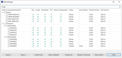

_Leo_
In MCUXpresso IDE v11.9.0 of you click in ConfigTools -> Data Manager, you will see the tools that are supported for each boad/part.

My Data Manager shows the available Peripherals tool:

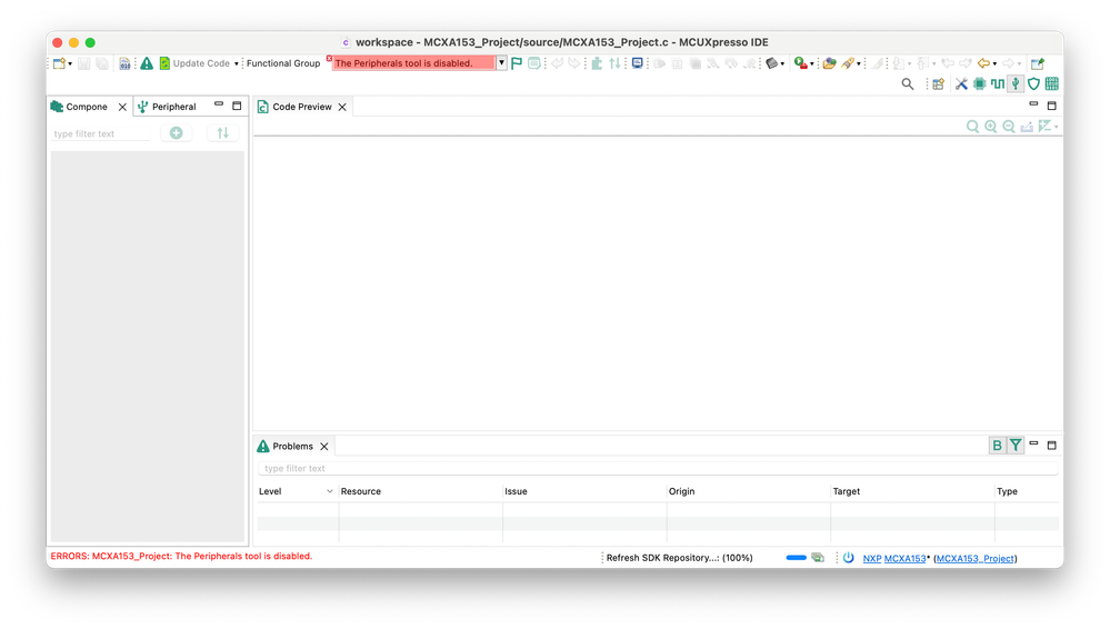

However, in the Peripherals tab there is a message " ERRORS: MCXA153_Project: The Peripherals tool is disabled.":
How can I enable this tool?
Other processors, e.g. LPC55s69, have Peripherals tool enabled.

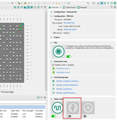

_Leo_
This is part of the principal view of ConfigTools, you need to enable

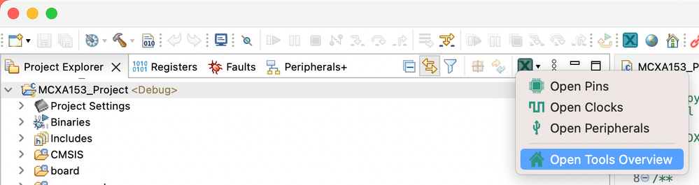

Thank you for the information, but the Tools Overview window is not visible in my IDE. Clicking the Open Tools Overview button has no effect. I checked in MCUXpresso 11.9 and 11.8 (both versions for macOS).

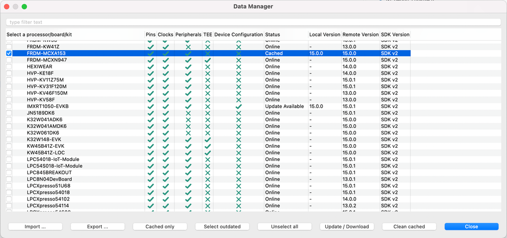

danielkrol
I checked this problem on 2 different computers (Apple M1 and Apple M2 MAX) - there is a BUG in the version for Apple Silicon. I downloaded the Intel version and ran it via Rosetta - everything works!
