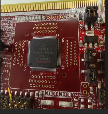

I would like to know what is manufacturing date from this device MC56F84763VLHR, I can read from component body the marking as these: MC56F84763V at top, 2N27E at center and CTKN303J at bottom. #MC56F84763VLHR #DIGITALSIGNALCONTROL #DATECODE

I took a picture of mask of 56F84789 silicon, the date code is 1209, it means that the manufacturing date is 2012 year 09th week.
Hope it can help you

So, does this means mine is week 3 of 2003? Marking calls for CTKN303J in a MC56F84763V
3,064件の閲覧回数
xiangjun_rong
The MC56F84xxx was launched in 2012 year, so it is impossible to label 03xx.
can you take a picture of mask of MC56F84763V?
