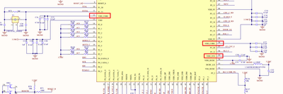

  1. I guess you are using a custom board, could you please share your schematic?

  1. I guess you are using a custom board, could you please share your schematic. Attached

Hello @ma0208 ,
Thanks for your reply. I previously reviewed your schematic in a private support case and recommended that VDD_SYS and VDD_CORE should not be tied to 3.3 V. I see you updated the schematic by removing the 3.3 V connection. It's okay.
To ensure the design meets specifications, I suggest you can measure the relevant pins with a multimeter (and an oscilloscope if needed) to verify voltage and ripple against the datasheet electrical and timing specifications.
Furthermore, there is a design checklist posted on the MCXNx4x webpage that should also be used when designing in these devices (https://www.nxp.com/webapp/Download?colCode=MCXNSERIES-DESIGN-IN-CHECKLIST&appType=license).
If helpful, feel free to share the updated sections. I’m happy to take another quick look.
