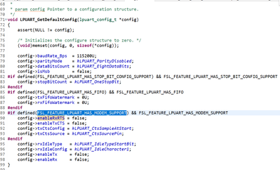

Hi @koj
1. First, i think you can refer to the MCX Nx4x Reference Manual Chapter 66.5.2.3.3
Hardware flow control.
2. Then Check RTS/CTS Functionality with Logic Analyzer
Since your logic analyzer does not show RTS toggling. So you can use a simple test where you manually set/clear RTS.
3. Test with Bare-Metal Code
You can test the SDK lpuart_polling example.
This demo has FSL_FEATURE_LPUART_HAS_MODEM_SUPPORT feature.
You can config the RTS/CTS pin and test this demo.
Harry

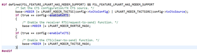

koj
After taking the time to debug this I see that the fsl_lpuart_freertos.c uses the fsl_lpuart.c ring buffer feature and the LPUART_TransferHandleIRQ doesn't stop reading from the UART->DATA when the ring buffer is full.  The IRQ Handler just reports an overrun, which the LPUART_RTOS_Callback() uses to eventually abort the Receive, and overwrites the the oldest data instead.
Since the DATA is always read the RTS line is never deasserted because the STAT[RDRF] is never 1.
The fsl_lpuart.c driver only sets the MODIR[RXRTSE] during init, and doesn't consider flow control fully.
2,539 Views
Harry_Zhang
Hi @koj
"The fsl_lpuart.c driver only sets the MODIR[RXRTSE] during init, and doesn't consider flow control fully."
If you enable the RxRTS and TxCTS in the LPUART_Init.
        /* Set the CTS configuration/TX CTS source. */
        base->MODIR |= LPUART_MODIR_TXCTSC(config->txCtsConfig) | LPUART_MODIR_TXCTSSRC(config->txCtsSource);
        if (true == config->enableRxRTS)
            /* Enable the receiver RTS(request-to-send) function. */
            base->MODIR |= LPUART_MODIR_RXRTSE_MASK;
        if (true == config->enableTxCTS)
            /* Enable the CTS(clear-to-send) function. */
            base->MODIR |= LPUART_MODIR_TXCTSE_MASK;
 Do you mean this won't work?
Harry
