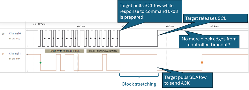

I am trying to use the I3C peripheral on the FRDM-MCXA153 to communicate with an I2C target that requires clock stretching. I have added 10k pull-up resistors at R61 and R62 as instructed here https://community.nxp.com/t5/MCX-Microcontrollers/I3C-SDA-and-SCL-pin-configured-for-Pullup-Enabled-...). This does seem to get I2C communication started. The I2C target device ACKs its address, and I can successfully send a command to the device. The device then holds the clock low while preparing its response. However, when the target finally pulls SDA low to ACK that its response is ready and then releases SCL, the MCXA153 controller fails to resume clocking.
Is there a setting that is necessary to prevent this kind of timeout?
I am using the fsl_i3c driver. The write operation is performed by I3C_MasterTransferBlocking. That function calls I3C_MasterSend at line 1974 in order to send the command byte 0x08. Following the write to the controller data byte register, I3C_MasterWaitForComplete(base, false) is called (line 1558). This returns a result of 7903 (kStatus_I3C_WriteAbort). How do I get the controller to wait until the clock stretching is complete to check for the ACK?

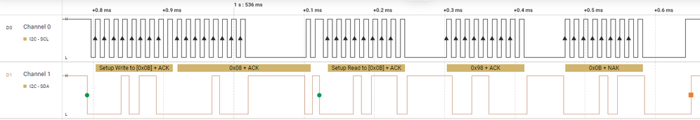

For your reference, if I instead use the LPI2C peripheral to communicate with the same target, the ACK is properly processed following the clock stretching. Here is what successful communication looks like:
You can see that following the 0x08 write, and the long clock stretch, the controller resumes clocking in order to process the ACK (at approximately the +0.1ms marker). Since the ACK was received in this case, the controller continues to perform a successful two byte read operation.

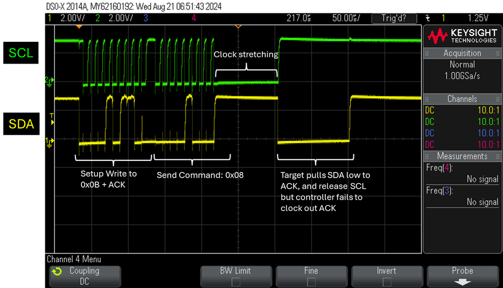

I am aligned with Design team, MCXA153 I3C doesn't support I2C stretch function.
MCXA156 I3C supports I2C stretch function.

I have updated the i3c_polling_b2b_transfer_master demo to communicate with the I2C target device I am using (Texas Instruments BQ40Z80 Battery Pack manager). (The updated project is attached, with an updated README to describe the physical connections necessary. If you use git, you can compare the top of the main branch with the original commit to view differences).
In particular, I have configured the I3C SDA and SCL as open drain in pin_mux.c. Furthermore,  note the differences in the masterConfig and the masterXfer.
+ // masterConfig.enableMaster = EXAMPLE_I2C_CTRL_MODE;
+ masterConfig.disableTimeout = true;
- masterConfig.enableOpenDrainStop = false;
+ masterConfig.enableOpenDrainStop = true;
+ masterConfig.hKeep = kI3C_MasterPassiveSDASCL;
- masterXfer.subaddress = 0x01;
- masterXfer.subaddressSize = 1;
+ masterXfer.subaddress = BMS_TEMP_CMD;
+ masterXfer.subaddressSize = BMS_CMD_LEN;
- masterXfer.dataSize = I3C_DATA_LENGTH - 1U;
+ masterXfer.dataSize = I3C_DATA_LENGTH;
+ masterXfer.ibiResponse = kI3C_IbiRespNack;
With the above changes to attempt Open Drain I2C communication (to allow clock stretching by the target), the communication looks like that from the original post:
The target device ACKs its address, so the controller sends the query temperature command (0x08). The target then attempts clock stretching, but when it finally pulls SDA low to ACK and releases the SCL, the controller fails to clock out the ACK. I3C_MasterTransferBlocking returns with a result of 7903 (kStatus_I3C_WriteAbort /*!< The slave device sent a NAK in response to a write. */)

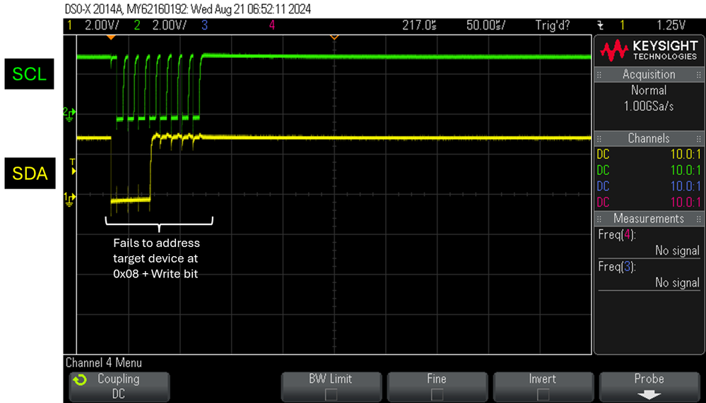

I also tried to implement I3C_MCONFIG[MSTENA] = 0b11. According to the Reference Manual, this enables I2C Controller Mode to allow clock stretching. If you uncomment line 86 (masterConfig.enableMaster = EXAMPLE_I2C_CTRL_MODE;), the I3C peripheral should be configured in this mode. Note that the SDK fsl_i3c driver doesn't even include I2C Controller mode in the i3c_master_enable_t.
However, with MSTENA = 0b11, the communication fails even earlier. The controller actually fails to properly clock out the target address, which should be 0x0B + Write bit = 0b:0001_0110. Instead, only 7 bits are transferred: 0b000_1111.

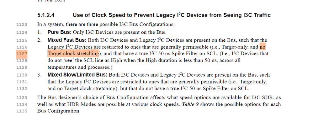

I wanted to jump in, although it might be a bit late, but I want to highlight that I3C does not allow compatibility with I2C devices that stretch the clock. So, if the I2C device uses clock stretching, then it cannot be connected to an I3C bus. You can read this from the MIPI I3C basic spec and the MIPI I3C FAQ.
These documents can be download form the MIPI webpage: https://www.mipi.org/specifications/i3c-sensor-specification?utm_term=mipi%20i3c&utm_campaign=I3C+se...
