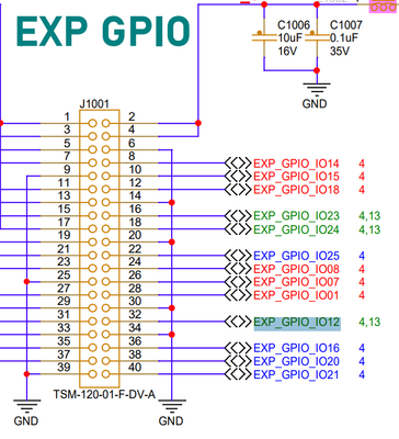

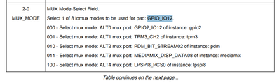

According to the reference manual, the Pad that you must set to use as TPM3_CH2 is GPIO_IO12:
That pad is exposed in the J1001 in EVK:
