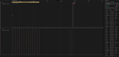

I have another problem.
if f slave pulls SDA line low immediately after the STOP condition as picture.
It seems like MCXN556/236 I3C IP can't detect the SDA failing edge, so it will not toggle SCL line to generate a START.
Does it match your expectation?
If yes, does it due to slave violate the Bus available condition?
タグ(1)

Hello @Bruce_Teng,
According to the I3C standard, the bus must remain in the Idle state for at least 1 µs before an IBI can be issued. To ensure this timing requirement is met, the device uses the CLK_SLOW . When an IBI request is pending, the internal counter driven by CLK_SLOW must complete one or more counts before the bus is considered fully idle and the IBI can be generated. As shown the following image obtained from the RM (MCXN236):
Also, in order to support you better, could you provide me the next information?
- Could you please clarify me if you have received any previous support of this specific part MCXN556?
- I am getting troubles to see the image that you shared in your previous post, could you share me it with higher resolution?
- Could you provide me the steps that you made to replicate this behavior?

Bruce_Teng
Hi @Habib_MS
No, I haven't received any support of this specific part MCXN556
Background:
In our system, MCU play a role of bridge between USB and downstream device (GPUs)
So, MCU charges of forwarding data from USB to GPU or GPU to USB.
Once GPU need to pass data to USB, GPU will arise IBI request, then MCU service it and read data from GPU, then forward it to USB.
Experiment:
Send GetStatus command before every transaction (read/write).
I get GPU information or update GPU firmware to trigger read/write transaction.
Note: I3C IP of GPU is not NXP product
タグ(1)

Bruce_Teng
In our system, MCU is I3C master and GPU is I3C slave.
So, it seems that we couldn't modify register setting to decide GPU how to detect the bus available condition. right?
If yes, should we focus on GPU behavior?
タグ(1)
2,581件の閲覧回数
Habib_MS
Hello @Bruce_Teng,
Thank you for your response. Based on your comments, the slave (CPU) does not meet the I3C requirement to keep the bus in the IDLE state for at least 1 µs before issuing an IBI request. Is my understanding correct? If so, this could explain why the master (MCU) is unable to process the IBI.
On the other hand, the AN14434 describes exactly the type of behavior expected for the MCU in your application. I highly recommend reviewing this document to ensure the MCU is working correctly.
Please let me know if you have any further questions.
