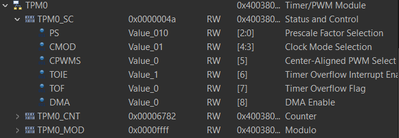

In the register is never written TOF to "1"!
As you can see in the picture, TOF is not set even when an timer overflow occurs.
2,734 Views
SvenAsbach
I have changed the clocksource from MCGIRCLK to MCGPCLK and it seems to work.
This clock is faster then I wanted.
