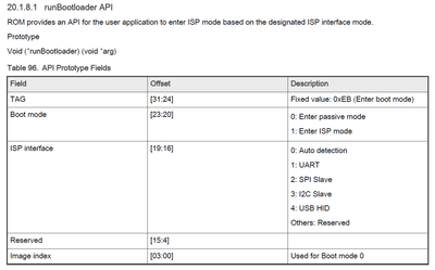

I have a FRDM-MCXA153 dev kit, I am using the dev kit to prototype a new device. I would like to enter ISP mode from user space as some of the pins will be used on the product and not immediately available for entering ISP mode.

In addition, ROM provides runBootloader API for the user application to enter ISP mode based on the designated ISP interface mode.
Below is extracted from RM
Hope this helps,
Jun Zhang
