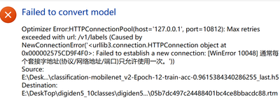

After training a model with EIQtoolkit, I intended to perform PTQ and validate it on the test set, but I encountered the error shown in the picture. I've tried restarting my computer multiple times and reinstalling the software, yet the problem persists. Now I've got no idea what to do.

Would you please share the screenshot of the error you are seeing?

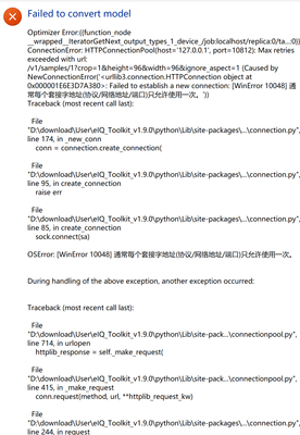

Sorry to bother but I just encountered another error as is shown below. I tried to deploy the model and it seemed to be wrong with the device. But I got no idea how to deal with this problem.

I'm really sorry. The image failed to upload when I made the post. Here is the error screenshot.
I've tried several times and got error messages shown in the two pictures.

Hi @Jasmine_zzz
Based on your screenshot, it seems to be a network issue. Can you try using a different network again?
