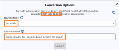

Habib_MS
Hello @Abdu_,
I successfully exported a TensorFlow INT8 model as a header file. This model was trained outside the eIQ environment and does not include quantization or dequantization nodes
Please use these params in the custom options:
dump-header-file-output; dump-header-file-input
In the other hand, in this page are more information about eIQ that could be helpful.
Habib

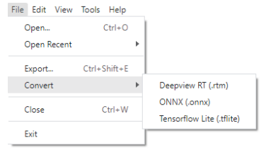

Habib_MS
Hello @Abdu_ ,
To answer your first question: the NPU currently supports only INT8 models. For more details, I recommend checking out this community post which provides further clarification.
Regarding your second question: the eIQ Toolkit includes a model conversion feature, as illustrated in the image below. This allows you to convert models into formats compatible with the supported hardware:
For a deeper understanding, please refer to Chapter 4.2: "Model Conversion" in the eIQ Toolkit User Guide, available on this page.
Additionally, you may find helpful resources on the official Google documentation, especially if you're working with TensorFlow Lite or other Google-supported frameworks.

Habib_MS
Hello @Abdu_,
Habib
6,436件の閲覧回数
Abdu_
Thank you so much, @Habib_MS. That worked well.
