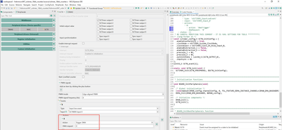

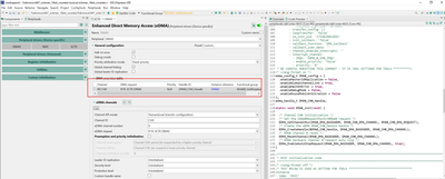

The configuration steps are as follows:
  1. Configure SCT_DMA as a DMA channel request.
  2. Configure the SCT DMA request through the DMA Request 0 register.
I recommend using the Peripheral Tool within the MCUXpresso IDE to configure these settings. This tool can automatically generate the necessary code for you. If you prefer to write the code manually, you can still refer to the generated code as a guide.
