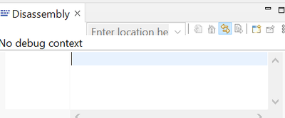

I want to know if in MCUXpresso IDE it is possible to create a new project only for assembler, not C/C++. In CodeWarrior, I could choose if I wanted C, C++ or ASM. In MCUXpresso IDE, is it possible?
Thanks.

MCUxpresso does not provide the option to create a project only in assembler.
However, you can use assembler with the next syntaxis:
Also, you can combine C with these instructions, as shown the images below:
On the other hand, MCUxpresso provides an alternative to see the disassembly of your code when you are in a debug session, where is show in the next window:

but... is there any possibility about including assembler support in new MCUXpresso IDE releases? We want to replace our 50 boards FRDM-KL25Z for 50 boards FRDM-MCXA153. With KL25Z, we use CodeWarrior 11.1 that supports that OLD board but, also, allows the creation of a assembler project. However, with MCAX153 boards, we need to use MCUXpresso IDE because CodeWarrior 11.1 doesn't support that board so new.

Does not have plans of add an option to create an assembly project in MCUxpresso.
