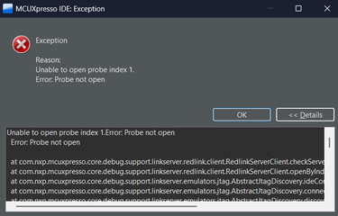

I am having a problem with my FRDM-MCXN947 . Whenever I try to debug or flash my project, I get this error :

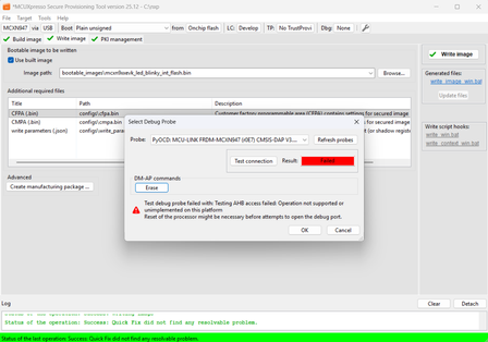

I already tried SPT erase but it didn't work. (Maybe I did it wrong.)
On the SPT, after activating ISP mode, I was able to perform the “build image” and “write image” operations, but erasing still does not work.

Please try using the Flash Programmer inside the SPT tool to erase and program a blinky SDK demo, and check whether it works properly. For details, please refer to the video in the attachment.
If these steps work well but you still cannot debug with the onboard debugger, please use an external debugger to test.

I followed the instructions in the video, and the method works to make the LED flash.
However, I get the same error when I return to the debugger from the MCUXpresso IDE.

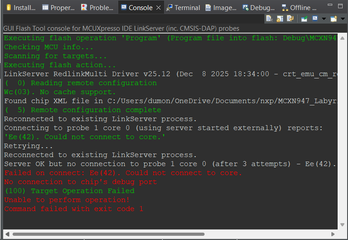

I updated LinkServer as suggested, but I think I already had it after the problem appeared. I tried the update again anyway, then power-cycled the board, created a new workspace, and imported a demo project, but I am still getting the same Ee(42) error when trying to debug.
I have recorded a short video showing the process, which I have attached.

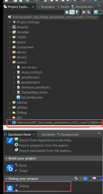

Please delete the .launch file (in below picture)and erase your board again.
Use the Debug button shown in the picture below to start debugging.
If it still doesn’t work, I recommend replacing the board.
