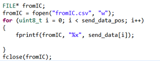

I am wanting to print contents to a file using the C function "fprintf()," but it does not work.
My device is QN9080 and I run some SDKs in MCUxpresso IDE. I set library/header to semihost config (already test every setting like Redlib, Newlib, NewlibNano in semihost). Some parts of my very simple code is below (send_data is a data which I want to write in .csv)
Here, .csv file is generated well, but code makes some errors at fprintf(); The error is...

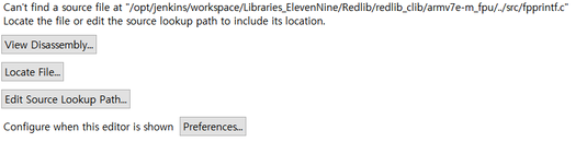

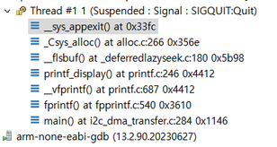

As I mentioned in my main post, of course I already have read the posts you inform. But those are not helpful to me. I think my problem is a different kind of errors (something like I cannot use fprintf() itself). Would you please see the picture I uploaded in my main post and consider my problem? (Same error appears when using like fputs(), fwrite()).
fopen() works well, and file generated in SDK folders well, but writing has an issue.
Why this kind of errors happen?:
Can't find a source file at "/opt/jenkins/workspace/Libraries_ElevenNine/Redlib/redlib_clib/armv7e-m_fpu/.../src/fpprintf.c
