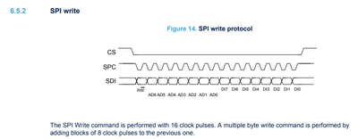

Hello everyone, I am using SDK example mcxn9xxevk_cmsis_lpspi_edma_b2b_transfer_master for MCX-N947-EVK. I am trying to achieve SPI read and write in 16 clock cycles as shown in picture for the accelerometer ism330dlc.
I have setup ARM_SPI_SS_MASTER_SW for the SPI SS pin control and tried to set it low/high manual before sending and receiving packet. The sequence of transmission is defined in platform_write and platform_read function.

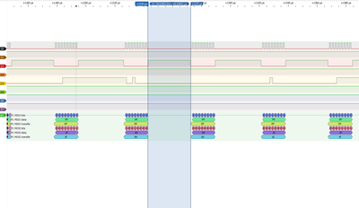

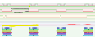

The yellow marked one is the read cycle and the read one is the write cycle.
The CS pin is pulled back to high after sending the register value for reading register value from the slave.
Please guide.

I shifted to SDK example mcxn9xxevk_lpspi_edma_b2b_transfer_master.
The CS pin is pulled high after each byte transfer in the default example.
To solve this, I added this before beginning of every transfer. Now, the CS is kept low during the whole transmission.
LPSPI_SetPCSContinous(EXAMPLE_LPSPI_MASTER_BASEADDR, (uint8_t)1);

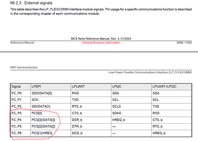

I have checked your code, it appears this is not SDK example code.
If you want to set the SPI in master mode and use DMA to transfer code, I suppose that you can not use a GPIO as CS signal to select slave spi device. You have to use FC_PCSx signal to connect /CS of slave SPI, which is driven automatically when the SPI master transfers data, it toggles for each byte or word.
If you do want to use GPIO pin, I suppose you can clear the GPIO before the DMA transfers data, after all data has been transferred, you can set the GPIO. The drawback of the method is GPIO is kept low during the transferring process.
This is the pin assignment for SPI_PCSx
