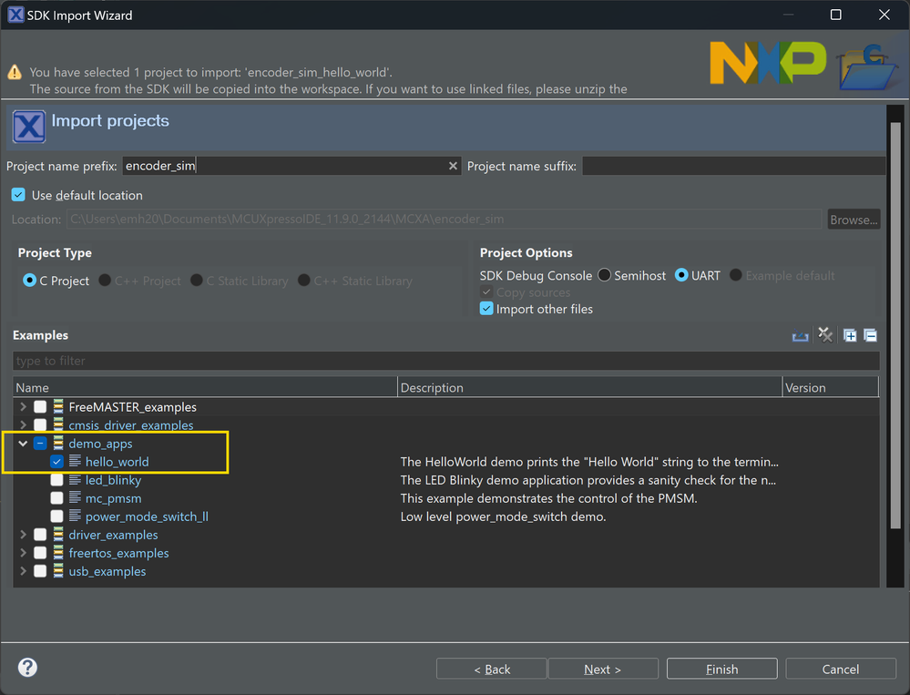

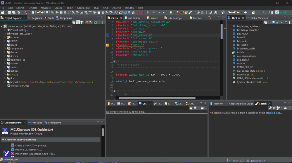

Step 1 : Create a new MCUXpresso Project
Create a new MCUXpresso project for the MCXA153. You can start with the “hello_world” application as a template. We called this project “encoder_sim.”

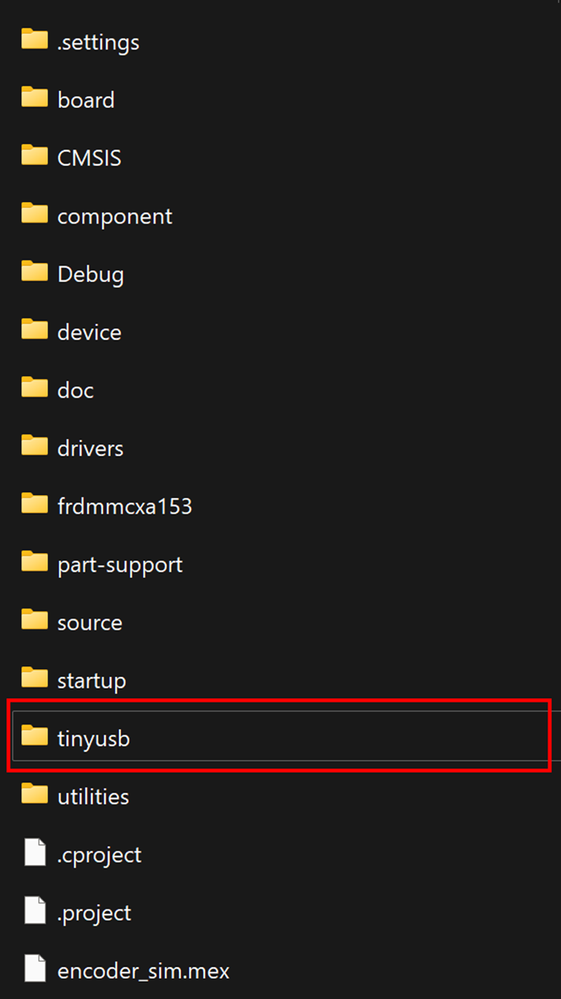

Step 2 : Add TinyUSB Source files to you project filesystem

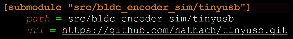

Clone the TinyUSB repository and place inside of the folder that contains your MCUXPresso project.
Note: If you place your main application in a git repository,  you can also git submodule the TinyUSB repo so you can either stay with most recent version or lock to specific commit.
It is also ok to just download a static copy of the files and place them into the project file system.  It is not necessary to directly place the TinyUSB folder inside of the MCUXpresso application folder. We could have chosen a folder outside of the main project source tree, but this example assumes that TinyUSB is in the same folder as the MCUXpresso application.

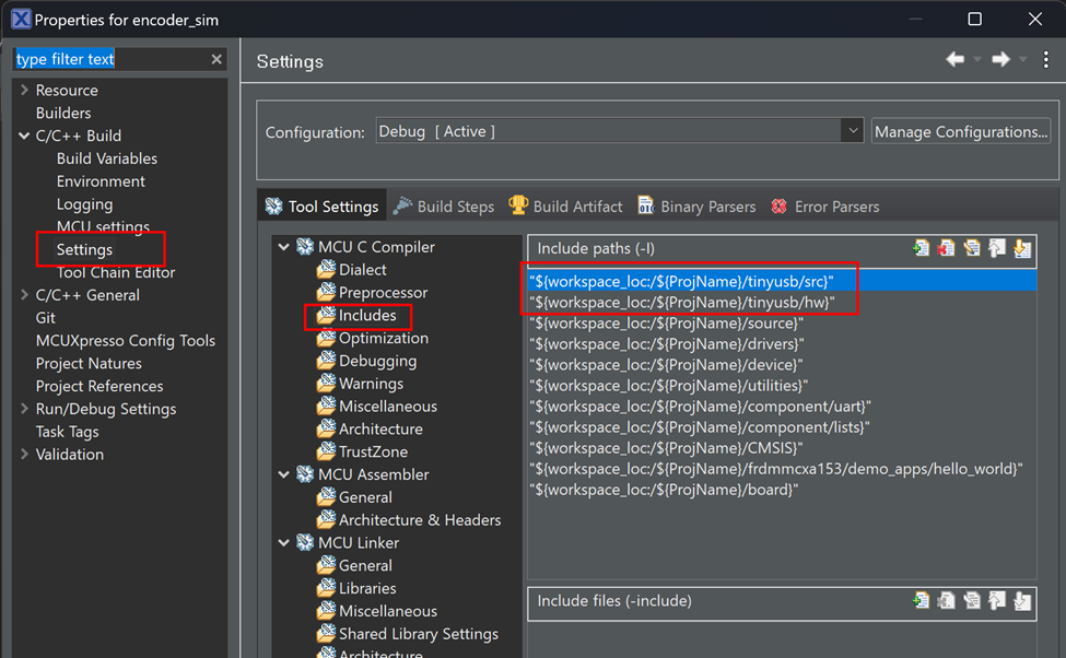

Step 4 : Update Include Paths
Add the tinyusb/src and tinyusb/hw folders to your project’s include path so our application can find all the of the core TinyUSB  header files.

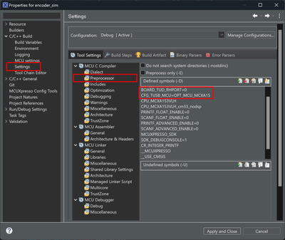

Step 5 : Add Build Configuration Symbols
We need two build symbols added to the project:
BOARD_TUD_RHPORT=0
CFG_TUSB_MCU=OPT_MCX_MCXA15

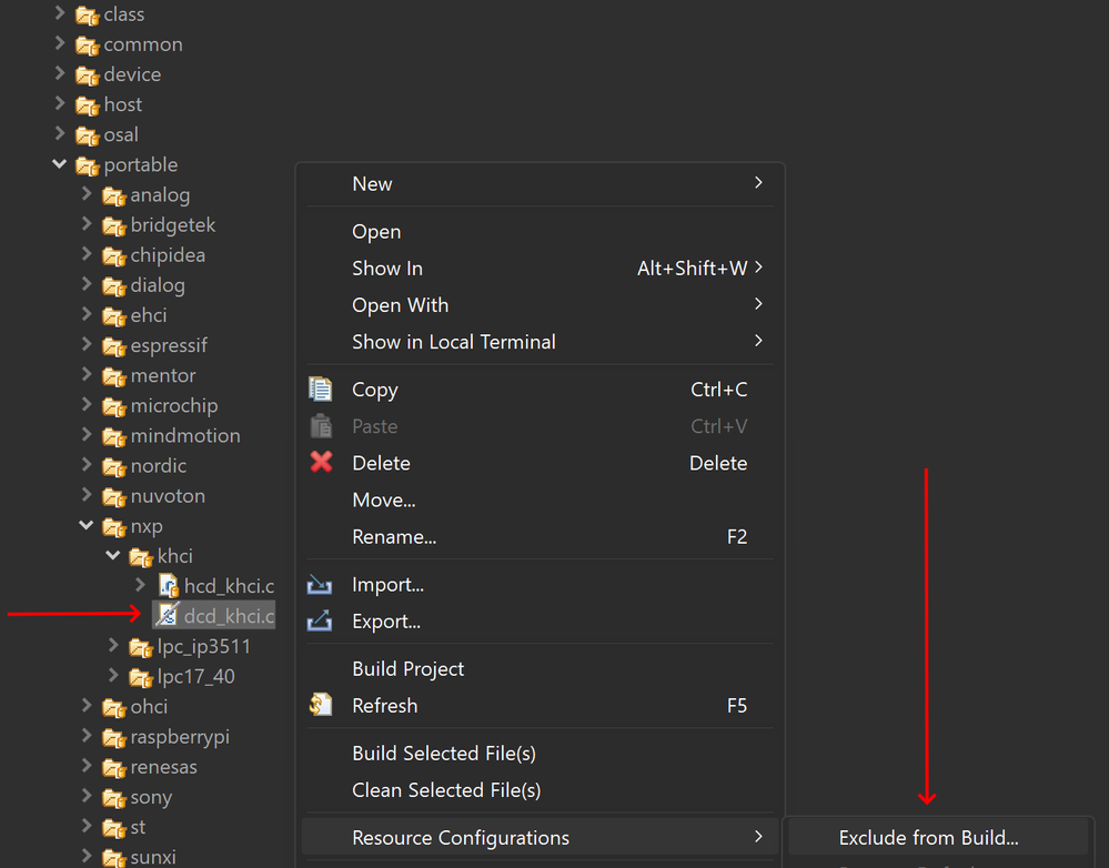

Step 6 : Exclude dcd_khci.c
Exclude tinyusb/src/portable/nxp/khci/dcd_khci.c from the project build.
Note:  We must remove this because we included the entire TinyUSB source tree with all the different vendor hardware support. This step may not be required with future version of TinyUSB. This example was built around version 0.17 as specified in tusb_option.h.

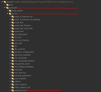

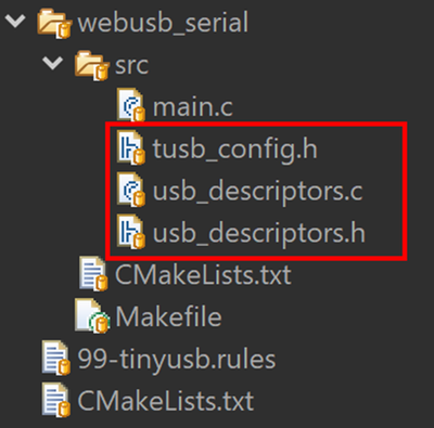

Step 7:  Use a TinyUSB example to configure your application
At this point, the core of TinyUSB is part of your project. From here you can use example specific files from TinyUSB/examples/device. In almost all cases,  you will need the tusb_config.h, usb_descriptors.c, usb_descriptors.h  in your project.
For this sample, I used the webusb_serial sample as a starting point for the USB descriptors and TinyUSB configuration.
Note:  As you study a TinyUSB example you will see generic calls to functions as board_led_write() and board millis(). TinyUSB has a small board HAL for its examples when building with the command line tooling. You can port these functions or remove them as needed in your own application.
