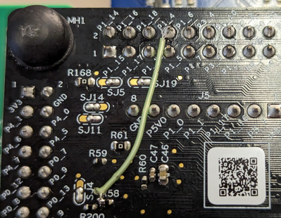

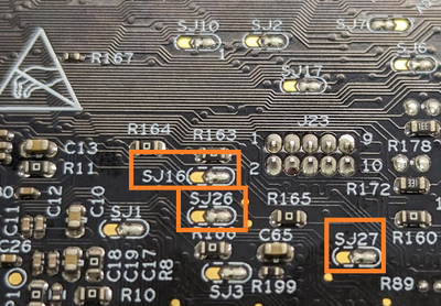

Camera colors are incorrect on FRDM-MCXN947 board
  • This modification will disable Ethernet functionality on the board due to a signal conflict with EZH D0 and ENET_TXCLK. If your project needs both camera and Ethernet functionality, then only move SJ16 and SJ26 to the left (dashed line side) and then connect a wire from P1_4 (J9 pin to the left side of R58. Then in the pin_mux.c file in the project, instead of using PORT1_PCR4 for EZH_Camera_D0, use PORT3_PCR0.
