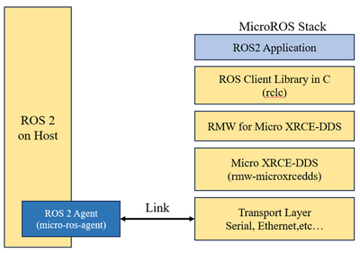

ROS 2 comprises RCL (ROS Client Library), RMW (ROS Middleware Interface), and DDS (Data Distribution Service). Porting ROS 2 to a new platform essentially involves creating a compatible RMW-DDS combination, leaving the RCL layer unaltered. Micro-ROS provides such an RMW-DDS combination.
Specifically, Micro-ROS employs Micro XRCE-DDS (a DDS standard designed for extremely resource-constrained environments) with a corresponding RMW implementation. This enables Micro-ROS to be compatible with ROS 2's architecture while efficiently running on resource-limited embedded devices.
Thus, porting Micro-ROS to different hardware platforms fundamentally involves interfacing communication protocols like UART (Universal Asynchronous Receiver-Transmitter) and UDP (User Datagram Protocol) with the Micro-ROS RMW-DDS combination. This process ensures effective communication between Micro-ROS and other nodes or external systems while maintaining the lightweight and efficient characteristics suitable for embedded devices.
From the above introduction, we can see that MicroROS transplantation mainly has two parts:
Connect UART/UDP communication and clock to implement the 5 functions in default_transport.cpp. Folder DDS+RMW+RCL generates libmicroros.a static library.

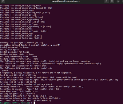

sudo apt update && sudo apt upgrade && sudo apt install ros-humble-desktop
source /opt/ros/humble/setup.bash && echo “source /opt/ros/humble/setup.bash” >>~/.bashrc
source /opt/ros/$ROS_DISTRO/setup.bash
mkdir uros_ws && cd uros_ws
git clone -b iron https://github.com/micro-ROS/micro_ros_setup.git src/micro_ros_setup
rosdep update && rosdep install --from-paths src --ignore-src -y
colcon build
source install/local_setup.bash
ros2 run micro_ros_setup create_firmware_ws.sh generate_lib

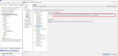

set(FLAGS "-O2 -ffunction-sections -fdata-sections -fno-exceptions -mcpu=cortex-m7 -mfpu=fpv5-d16 -mfloat-abi=hard -nostdlib -mthumb --param max-inline-insns-single=500 -D'RCUTILS_LOG_MIN_SEVERITY=RCUTILS_LOG_MIN_SEVERITY_NONE'" CACHE STRING "" FORCE)
set(CMAKE_C_FLAGS_INIT "-std=c11 ${FLAGS} -DCLOCK_MONOTONIC=0 -D'__attribute__(x)='" CACHE STRING "" FORCE)
set(CMAKE_CXX_FLAGS_INIT "-std=c++11 ${FLAGS} -fno-rtti -DCLOCK_MONOTONIC=0 -D'__attribute__(x)='" CACHE STRING "" FORCE)
set(__BIG_ENDIAN__ 0)
The above is how cmake is written.
Among them, "-mcpu=cortex-m7 -mfpu=fpv5-d16 -mfloat-abi=hard": These options specify the architecture and floating point unit characteristics of the target processor.
We can view the architecture and floating point unit characteristics of the MCXN947's target processor.
We can open MCUXpresso IDE, open a MCXN947 project, and check mcpu=cortex-m33 -mfpu=fpv5-sp-d16 mfloat-abi=hard in All options in settings->MCU Linker.
Therefore, the MCXN947 series is an M33 core. We need to change -mcpu=cortex-m7 to -mcpu=cortex-m33, and basically no other changes are needed. From this we can also see that a series of static libraries produced should be universal!

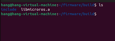

4.3 Building the Micro-ROS Static Library
Run the following commands:
ros2 run micro_ros_setup build_firmware.sh $(pwd)/firmware/toolchain.cmake $(pwd)/firmware/colcon.meta

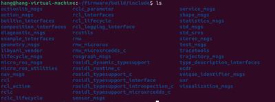

If the static library is successfully generated, you will see libmicroros.a in the firmware/build file.
5. Integrating and Testing the Static Library Locally

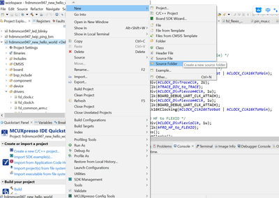

5.1 Adding the Generated Micro-ros Static Library to the Local Project

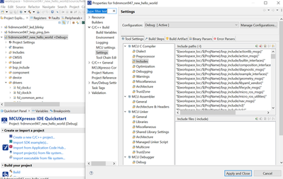

(1) Create a folder named bsp_include.
(2) Add all files from the include directory into your project under bsp_include.
(3) Add all paths in the include file to the include path.

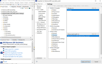

(4) Add the generated libmicroros.a static library to the project, for example, add it to bsp_include.
(5) Add the libmicrorots.a static library and name path to Libraries(-l) and Library search path(-L).

Setting up the Micro-ROS Agent (PC)
The agent establishes an interface between the Micro-ROS client on the MCU and ROS 2 on the host PC. To set up the agent:
# Go to the Micro-ROS workspace folder
cd microros_ws
# Source ROS 2
# Source local packages
# Create Agent
ros2 run micro_ros_setup create_agent_ws.sh
# Build Agent
ros2 run micro_ros_setup build_agent.sh
# Possible ROS Update
sudo rosdep init
rosdep update
