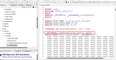

5.2 Place Model Data in XIP Region
Use the following method to place the model into the .model_data section (in C code):
__attribute__((section(".model_data")))
const unsigned char model_data[] = {
    #include "model_data.inc"

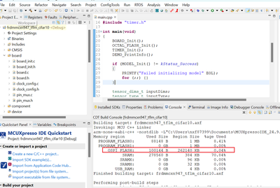

6. Build and Verify
After building the project, the Image Memory Map Report in MCUXpresso IDE will show that parts of the .text and .rodata sections have been successfully placed into the Octal Flash (OSPI_FLASH) region. For example:
OSPI_FLASH:      100144 B    262140 KB      0.04%

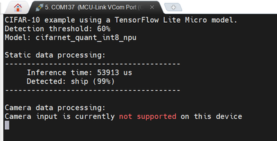

After downloading and running the program, the system boots from internal Flash and successfully reads model data directly from external Flash, completing the AI inference task.
