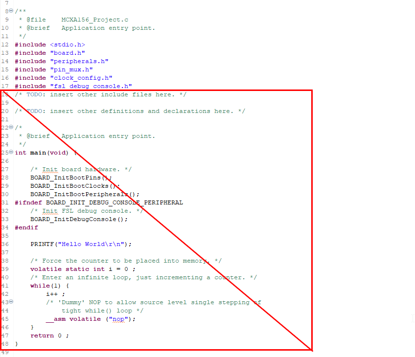

Upon creation, the project includes a basic "Hello World" example. This template can be used as a starting point. All content within the main source file—except for the initial macro definitions—can be replaced incrementally to integrate the application logic, allowing for a modular and controlled migration process.
The next step involves transferring the main source file from the original ST project into the newly created MCUXpresso project. During this process, standard ST includes, and driver references are excluded, unless custom header files are required. In this case, no custom headers are used, so only the core application logic is migrated.

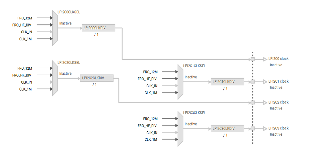

Tackling Clock Initialization using Clock Config Tool
The MCUXpresso IDE includes integrated configuration tools, which can be accessed via the Project Explorer by selecting the appropriate option from the drop-down menu located in the upper-right corner of the interface.

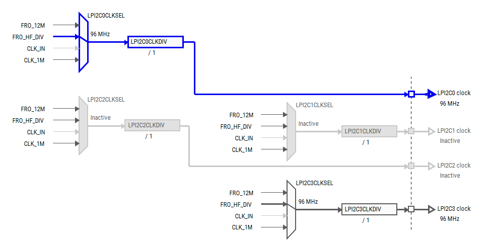

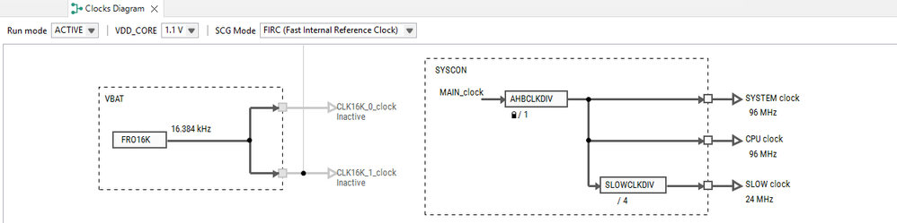

To configure the system clocks, open the Clocks tool within MCUXpresso IDE.
The clock diagram displays the supported configurations for the selected MCU. In this example, the device has a maximum core clock frequency of 96 MHz. As this meets the application's requirements, no modifications to the default clock settings are necessary.

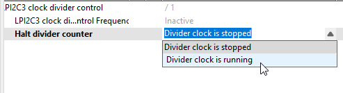

To enable the peripheral clocks for the I2C instances, navigate to the clock configuration diagram within the MCUXpresso Config Tools. Scroll through the diagram to locate the available peripherals and activate the I2C modules by selecting the appropriate clock sources.
To configure the clock source for the I2C0 and I2C3 peripherals, double-click on the CLKSEL field associated with each instance in the clock configuration diagram. For this setup, select FRO_HF_DIV as the clock source for both I2C0 and I2C3.
Next, configure the clock divider by selecting the corresponding field in the clock configuration diagram. The details will appear in the top-right panel of the interface. To enable the clock path to the I2C peripheral, ensure the option “Divider clock is running” is selected.
At this stage, the I2C peripheral clocks have been successfully enabled.
To apply and integrate the configuration changes into the project, click “Update Code.” This action will generate the corresponding source files and ensure the new settings are reflected in the project structure.

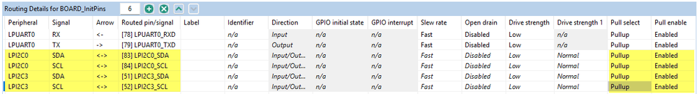

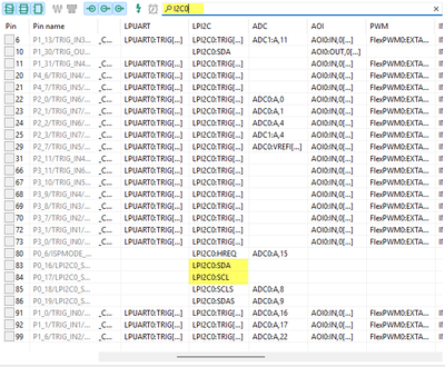

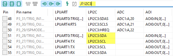

To begin configuring the I2C pins, select “Open Pins” from the configuration tool menu within MCUXpresso IDE.
Using the filter functionality, search for available pins compatible with I2C instance 0. After reviewing the board schematic, pins P0_16 and P0_17 were selected, as they are accessible via a header. Assign the appropriate I2C functionality to these pins by selecting LPI2C0:SDA and LPI2C0:SCL from the configuration options.
Repeat the configuration process for I2C instance 3. Based on the board schematic, pins P3_27 and P3_28 are selected for this instance. Assign the appropriate functionality by selecting LPI2C3:SDA and LPI2C3:SCL within the pin configuration tool.
Once the pin selections are made, a configuration table is generated displaying the routing and settings for each pin. Within this table, use the routing details to configure the pins as required. For the I2C pins, enable internal pull-up resistors to ensure proper signal integrity during communication.
In addition to configuring the I2C pins, it is necessary to set up two GPIO pins—one for input and one for output. On this board, SW2 (P1_7) is designated for button input functionality, while P3_0 is assigned for LED output.
Within the routing details of the pin configuration table, define the behavior for both input and output GPIOs. Based on the application requirements, the output pin should be initialized to a logical low state (select Logical 0) to activate the LED. For the input pin, enable interrupt detection on a falling edge to register button presses accurately.
To finalize the configuration and integrate the changes into your project, click “Update Code.” This will generate the necessary source files and apply the selected settings to the project structure.

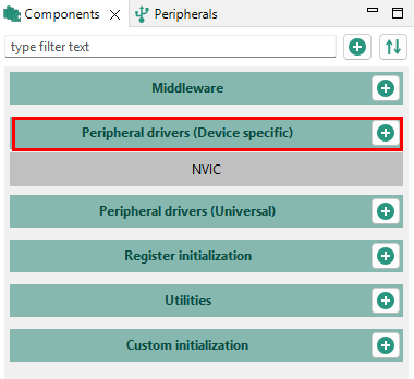

The MCUXpresso IDE features integrated configuration tools, accessible via the Project Explorer. To launch these tools, use the drop-down menu located in the upper-right corner of the interface.
To begin peripheral configuration, select “Open Peripherals” from the configuration tool menu within MCUXpresso IDE.
In this view, focus on initializing the GPIO and I2C settings for each instance. To proceed, select “Peripheral Drivers” to access the list of supported drivers available for the target device

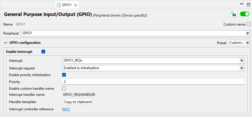

GPIO1 Configuration

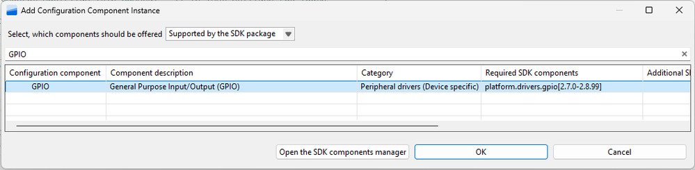

To filter the available peripheral options, enter “GPIO” in the search field within the Peripheral Drivers view. Once the relevant options are displayed, click “OK” to proceed with the GPIO configuration.

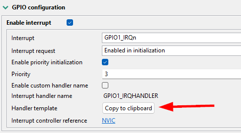

To enable the interrupt functionality for P1_7, which is assigned to the button input, begin by selecting a new peripheral driver. Use the filter to search for GPIO, then choose the appropriate driver to activate the GPIO1 interrupt handler.

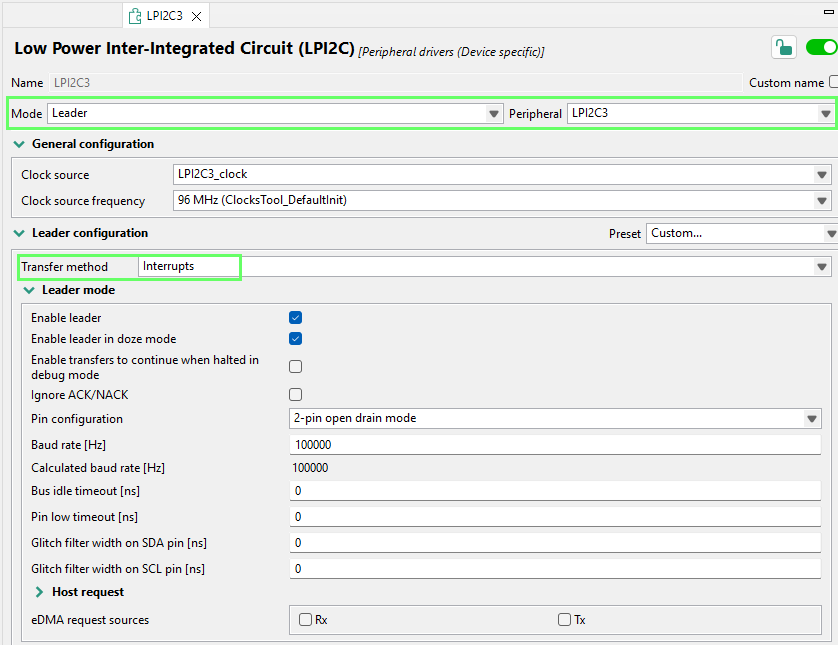

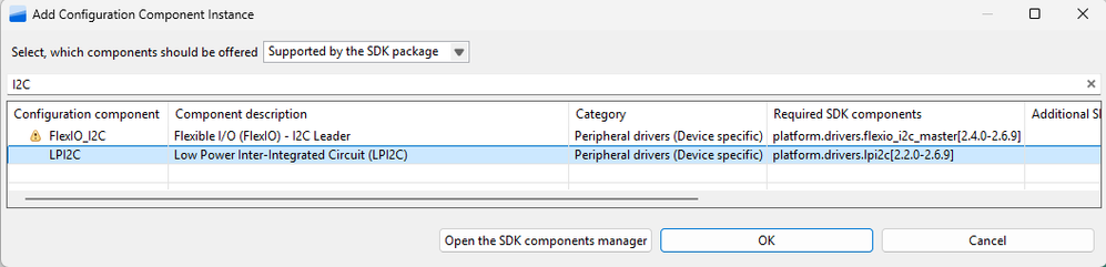

I2C3 Leader/Master Configuration
To configure the I2C peripheral, filter the available options by entering “I2C” in the search field within the Peripheral Drivers view. Once the relevant driver is displayed, select the appropriate one for your application and click “OK” to proceed.

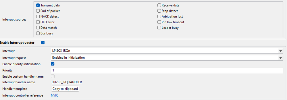

Configure I2C3 as the master (leader) device and enable interrupt-driven data transfer. This setup allows the I2C3 instance to initiate communication and handle data transmission using interrupt mechanisms for improved responsiveness and efficiency.
Additionally, enable the interrupt handler for the I2C3 peripheral. Configure the appropriate priority level and activate the Transmit Data Ready flag to support interrupt-driven data transmission.

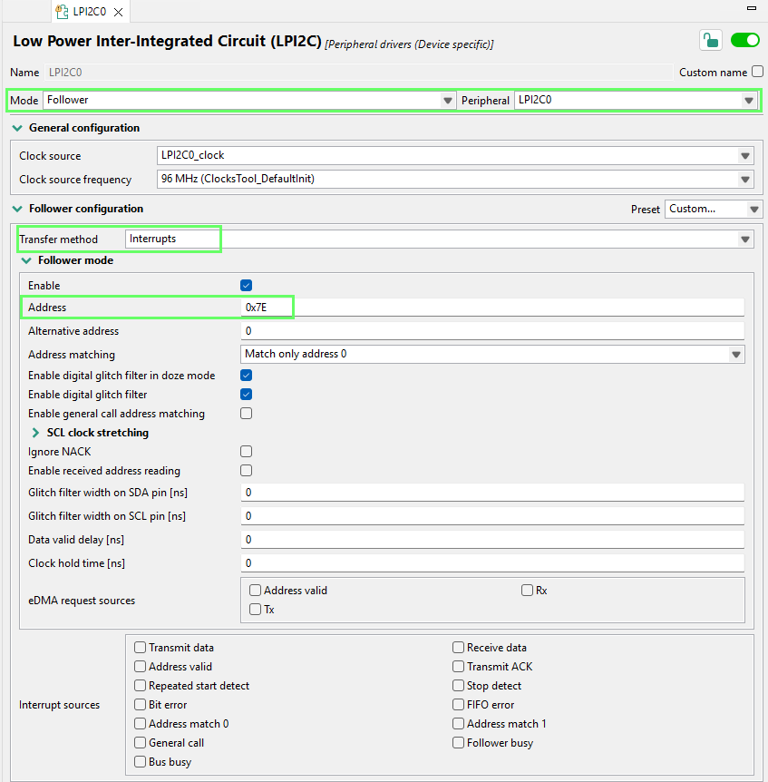

I2C0 Follower/Slave Configuration
To configure the I2C0 follower peripheral, filter the available drivers by entering “I2C” in the search field within the Peripheral Drivers view. Once the relevant driver is displayed, select the appropriate one and click “OK” to proceed with the configuration.
Configure I2C0 as the slave (follower) device. Enable the interrupt-driven transfer method and specify the slave address to be used for communication. This setup allows the I2C0 instance to respond to master requests and handle data reception via interrupts.
Additionally, enable the interrupt handler for the I2C0 peripheral. Configure the appropriate priority level, validate the assigned follower address, and activate the Receive Data Ready flag to support interrupt-driven data reception.
To apply the configured settings and integrate them into the project, click “Update Code.” This action will generate the necessary source files and ensure that all peripheral and pin configurations are reflected in the project structure.

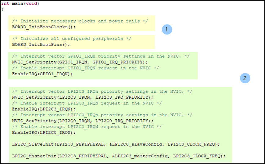

  1. Clock and Pin Initialization
    In the main function of the NXP-based project, system clocks and pin configurations are initialized using the functions generated by the configuration tools:
    • BOARD_InitBootClocks
    • BOARD_InitBootPins
  2. Peripheral Initialization
    Initialization code for peripherals is sourced from the peripherals.c file generated by the Config Tools. The first block of code sets up the GPIO interrupt handler, including its priority level and NVIC configuration.
Following this, the I2C master and slave instances are initialized along with their respective interrupt handlers and priority levels. At this stage, interrupt flags are not yet enabled; they will be activated later within the data transfer function to ensure proper sequencing and avoid premature interrupt triggering.

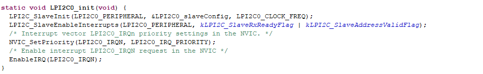

The peripherals.c file includes a code snippet specifically for initializing the LPI2C0 peripheral for slave operations. This code can be selectively integrated into the main function or other appropriate locations within the application to align with the desired execution flow.
While the configuration tools in MCUXpresso IDE effectively generate the necessary initialization code, it remains the developer’s responsibility to determine the most appropriate placement of this code within the application. This decision should be guided by the operational sequence required by the specific protocol or peripheral being implemented.
For example, in I2C communication, data transfer is managed through interrupts. If the LPI2C0_Init function is used without consideration for timing, interrupts may trigger prematurely, resulting in incomplete or mismanaged transactions.
To ensure proper execution, the recommended sequence is:
  1. Initialize the peripheral and its associated interrupt handler.
  2. Start the I2C transaction.
  3. Enable interrupts for both master and slave operations.
In this application, the initialization is performed within the main() function, while the interrupt flags are selectively enabled later within the Handle_I2C_Master function to maintain correct timing and control.

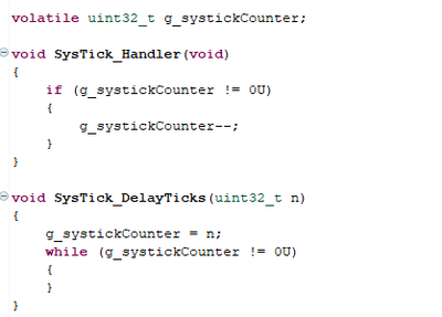

  1. SYSTICK Initialization
    The SYSTICK timer is configured to support delay operations within the application, such as controlling the LED blinking rate. Detailed instructions for initializing SYSTICK are provided in the following sections.

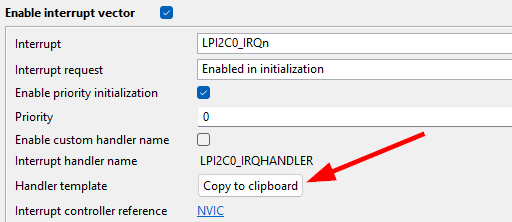

Interrupt handlers for both master and slave I2C instances are derived from the peripheral initialization code. At this stage, relevant interrupt flags are selectively enabled to support the specific behaviors required by the application.

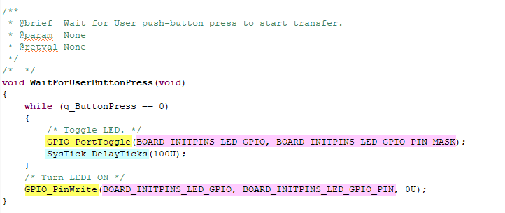

WaitForUserButtonPress Function
To begin customizing the GPIO interrupt handler, open the Peripherals Config Tool within MCUXpresso IDE. From there, you can copy the auto-generated IRQ handler for GPIO, which serves as a reliable starting point. This code can then be modified to suit the specific requirements of your application.
To return to the code editor after configuring peripherals, click the “Develop” button located in the upper-right corner of the MCUXpresso IDE. Once in the development environment, paste the copied IRQ handler code into the main source file—ideally near the top—for easier access and organization.

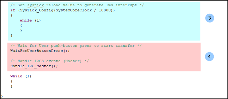

Modifications were made to include a control variable within a while loop, allowing the application to pause execution until a button press is detected. This ensures that the program proceeds only after user interaction, aligning with the intended flow of the application.
The WaitForUserButtonPress function utilizes GPIO toggle and write operations to control the LED state, along with a delay mechanism to manage the blinking interval during the polling loop. To implement the delay, the SYSTICK timer is initialized and configured accordingly.
Additionally, a global counter variable is introduced, along with the corresponding SYSTICK interrupt handler, to support time-based operations within the application.
Within the main() function, the SYSTICK timer initialization should be added prior to the button polling logic. This ensures that the delay mechanism is fully operational before entering the loop that waits for user input.
The finalized WaitForUserButtonPress function will include:
  • GPIO operations to toggle and control the LED state.
  • A while loop that continuously checks the button state and proceeds only upon detection of a press event.
The GPIO_* APIs are part of the NXP GPIO driver library and are used for various operations such as initialization, pin control, and interrupt handling. The macros highlighted in the code—typically shown in pink within the IDE—are generated by the Config Tools and defined in the pin_mux.h header file.
The delay functionality used in the application is implemented through a custom SYSTICK-based function, as previously described.
To explore the full set of available GPIO APIs, refer to the fsl_gpio.h header file. This file provides comprehensive support for GPIO operations, including port and pin-level control, configuration, and interrupt management.

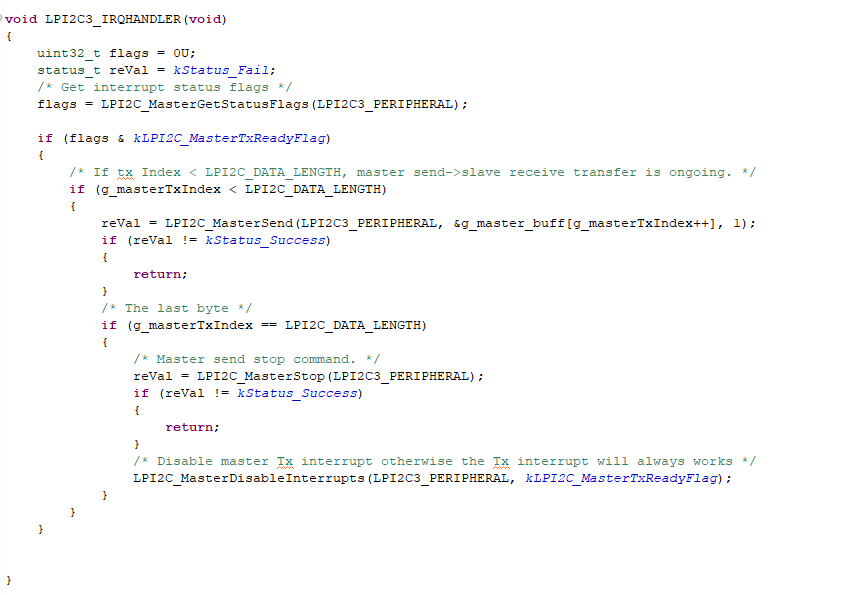

Customizing the I2C Interrupt Handlers
To customize the I2C interrupt handlers in a manner similar to the GPIO handler, begin by opening the Peripherals Config Tool in MCUXpresso IDE. From there, locate and copy the auto-generated IRQ handler for I2C0. This serves as a foundational template that can be modified to meet the specific requirements of the application.
To return to the code editor, click the “Develop” button located in the upper-right corner of the MCUXpresso IDE. Once in the development environment, paste the copied I2C interrupt handler code into the main source file—preferably near the top—for better organization and accessibility.
Repeat the same process for I2C3 by copying its auto-generated interrupt handler from the Peripherals Config Tool. This handler can then be used as a base for customization, similar to the approach taken with I2C0.
Consolidating I2C Interrupt Handlers
In the original ST-based project, each I2C instance utilized two separate interrupt handlers: one for standard operations and another for error handling. However, the NXP MCU used in this migration provides a single interrupt vector per I2C instance, which handles both standard and error conditions.
As a result, the functionality of the original four handlers must be consolidated into two—one for each I2C instance. This requires a careful review of the original interrupt logic to ensure that all relevant flags and behaviors are preserved in the merged implementation.
For example, the slave handler in the original project checks for an address match flag and, upon detection, verifies readiness to receive data. The equivalent behavior in the NXP environment is implemented by monitoring the appropriate status flags within the unified interrupt handler, ensuring that both address recognition and data reception are handled correctly.

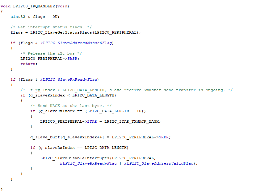

Slave Handler
The I2C slave interrupt handler is triggered when the master device addresses the slave at 0x7E. Upon detecting this address match, the slave acknowledges the request and prepares to receive incoming data.
The second part of the handler manages the data reception process. It handles each byte transmitted by the master, monitors for a NACK (Not Acknowledge) condition to signal the end of transmission, and stores the received data into a designated buffer. This ensures that the slave processes the communication sequence correctly and terminates the transfer gracefully once all data has been received.
Master Handler
The I2C master interrupt handler monitors the Master Transfer Ready flag, which indicates that the peripheral is prepared to transmit the next byte of data. Upon detecting this condition, the handler checks the transmit buffer to determine if additional data remains to be sent. A counter is used to track the progress of the transmission.
Using the appropriate Master Send operation, the handler transmits the next byte and advances the buffer pointer. When the final byte is sent, the handler issues a STOP condition to signal the completion of the data transfer sequence.

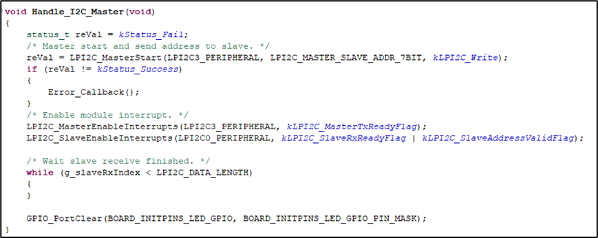

Handle_I2C_Master Function
The Handle_I2C_Master function is responsible for initiating and managing the I2C communication process. It begins by issuing a MasterStart command to initiate communication with the slave device at the specified address. Upon successful acknowledgment from the slave, the data transfer is handled through the corresponding interrupt routines.
This function also initializes the interrupt handlers for both the master and slave I2C instances. As previously noted, it is essential to enable interrupts after the master initiates communication to prevent premature interrupt triggering, which could disrupt the transaction sequence.
Once the data transfer is complete and the slave has received all expected bytes, the function concludes by setting the LED to a steady state—indicating successful execution and the end of the application flow.
