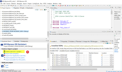

1.1 Load MCUXPresso tools and drag SDK to the Installed SDK menu
Then click “Create a new C/C++ project”

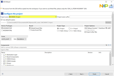

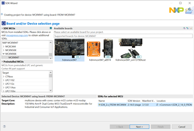

1.2 Select the board or processor, then clock “Next” software button
1.3 Name the project and Select the driver.
In the menu, it is okay to use default configuration, then clock “Finish”

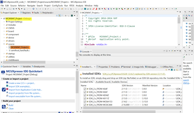

1.4 A New project called MCXN947_project is created with C language

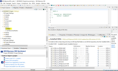

1.5 Delete the MCXN947_project.c and add the main.s
Click the “source” group with right mouse button, the click “New”->”source File”
1.6 Add the main.s as the following Fig and click “Finish”
1.7 The final project is like:
