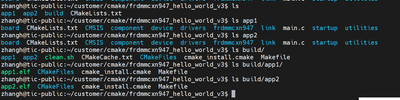

Harry_Zhang
Hi @Peter19
I didn't refer to your code, but the architecture is the same.
I refer to the mcxn947 SDK hello world demo.
The picture is the results.
The build folder is the generated folder.
May I ask if this meets your needs?
Due to our company's policy, I am unable to share my code.
If this meets your needs, i will send this code to the local fae.
Harry

Harry_Zhang
Hi @Peter19
Hi @Peter19
Based on your needs, I have redesigned this project. The project is based on the Hello world in SDK.
This project contains all the files of the Hello World project.
project-root/
├── CMakeLists.txt
├── app1/
│ ├── CMakeLists.txt
│ ├── main.c
├── app2/
│ ├── main.c
After compilation, there will be two executable programs, app1 and app2.
Harry
