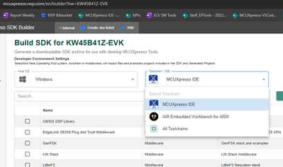

I still don't understand how to reproduce the problem, from what I see, this SDK does not have arm-gcc type support so cannot be used under vscode extension.
Similar, KW45 is not available under github.
Consequently, SDK examples will not compile.
So, can you detail how you imported the project? From an SDK? Or from MCUXpresso IDE? And how did you used a potential SDK that you have?

I imported the NXP MCU example "kw45b41zevk_digital_key_device_freertos" into VSCode using Import Project from folder. MCUxpresso for VScode generated some files Launch.json, cmake-kits.json, cmake-variants.json, settings.json, mcuxpresso-tools.json.
When I press F5,  VSCode displays the message below:
Could not read settings from mcuxpresso-tools.json for project "c:\_dev\digital_key_device-vscode\kw45b41zevk_digital_key_device_freertos"
