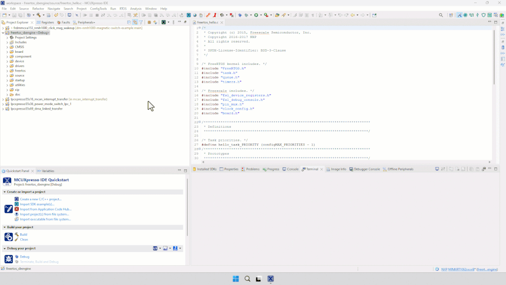

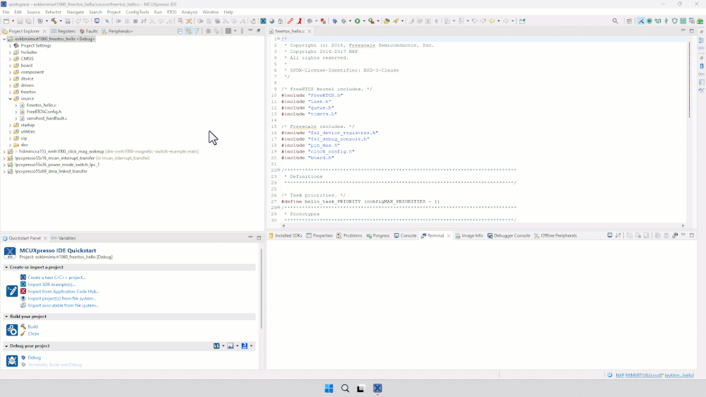

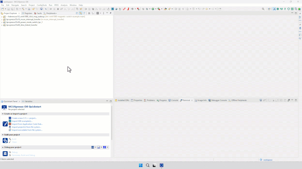

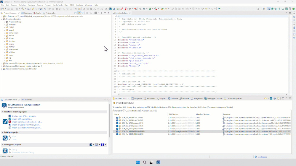

1. Import the freertos_hello example into the workspace. Be sure to set the library type to Newlib (semihost).
2. Rename the project to freertos_sbengine.

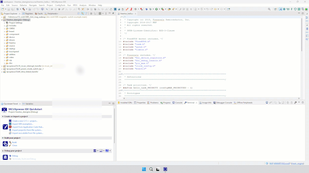

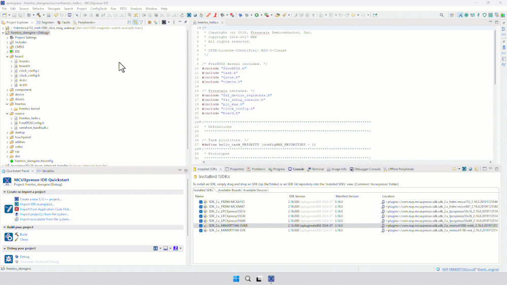

3. Add drivers to the project. Right click on the project and select SDK Management -> Manage SDK Components.
NOTE: Select Keep Existing and do not replace the FreeRTOSConfig.h file when prompted after adding the following components:
  • Under Drivers -> Device -> SDK Drivers, select:
  1. cache
  2. elcdif
  3. pxp
  • Under Board Components -> Device -> SDK Drivers, select:
  1. ft5406_rt
  • Under Software Components -> Device -> SDK Drivers, select:
  1. video-common

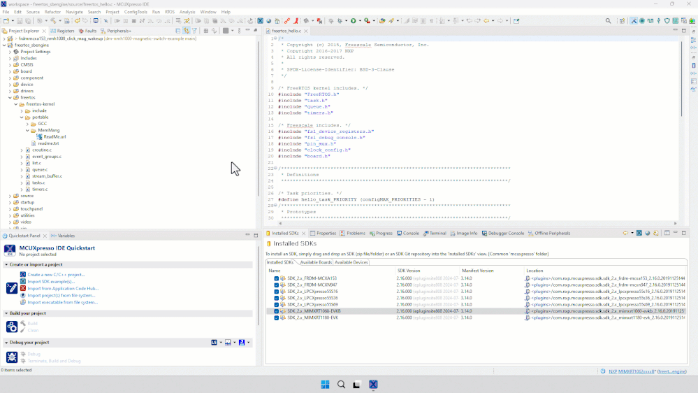

  • Change the memory manager configuration from the default used by FreeRTOS.
Remove the heap_4.c from the project folder. This is found in freertos/freertos-kernel/portable/MemMang.
Add the heap_3.c into the project folder freertos/FreeRTOS/portable/MemMang. This file can be found in the MIMXRT1060-EVKB SDK.

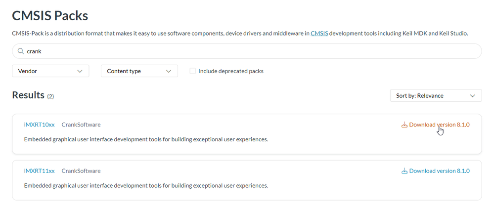

5. Download the Crank Software pack from Arm Keil | CMSIS Packs.
6. Import the Crank Software pack into MCUXpresso IDE.

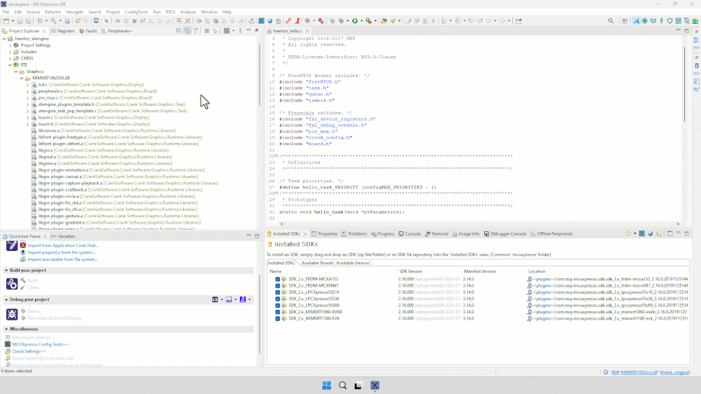

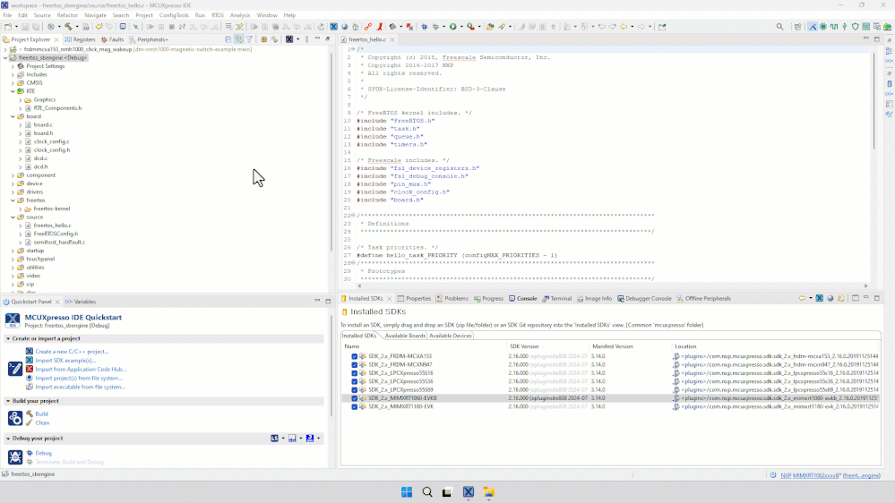

To add the components, right click on the project and select SDK Management -> Add Open-CMSIS Components:
Once the components are selected press Ctrl + s to save the components in the project.

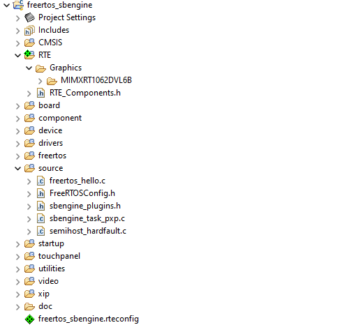

  • Copy sbengine_task_pxp_template.c and sbengine_plugins_template.h from the RTE -> Graphics folder into the source folder of the project. Rename these files to remove template  from the name.
The project source folder should now look like this:
  • Exclude the sbengine_task_pxp_template.c and sbengine_plugins_template.h files in the RTE -> Graphics folder from the build.

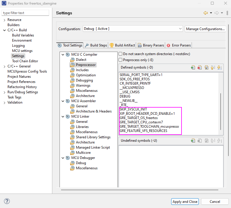

Right click on the project and select Properties -> C/C++ Build -> Settings -> MCU C Compiler. Add the following defines to the “Defined symbols (-D)” pane:
SKIP_SYSCLK_INIT
XIP_BOOT_HEADER_DCD_ENABLE=1
GRE_TARGET_OS_freertos
GRE_TARGET_CPU_cortexm7
GRE_TARGET_TOOLCHAIN_mcuxpresso
GRE_FEATURE_VFS_RESOURCES
Change the SDK_DEBUGCONSOLE define from:
SDK_DEBUGCONSOLE=0
to
SDK_DEBUGCONSOLE=1

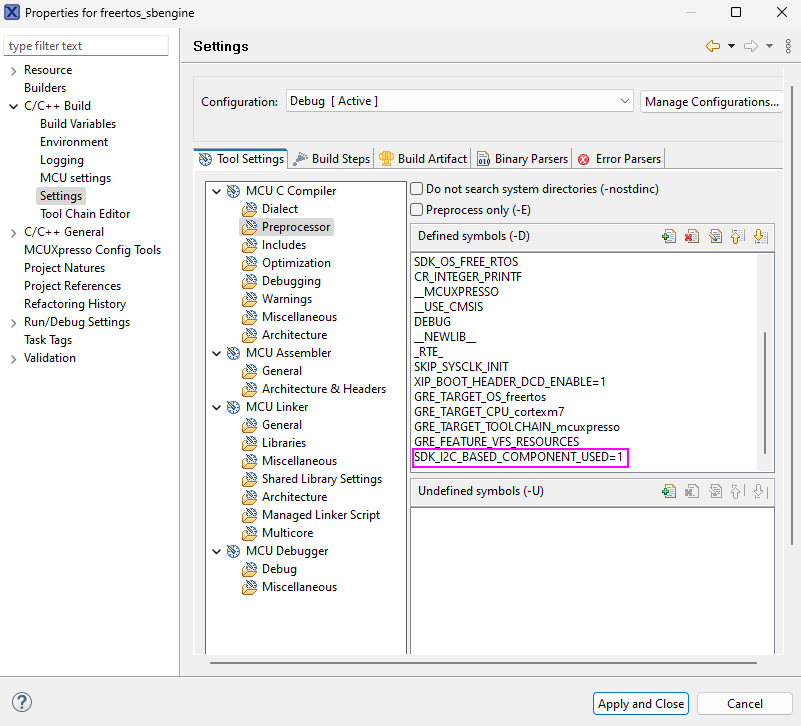

If you are using the gt911 touch driver, you will also need to add the following preprocessor define:
SDK_I2C_BASED_COMPONENT_USED=1

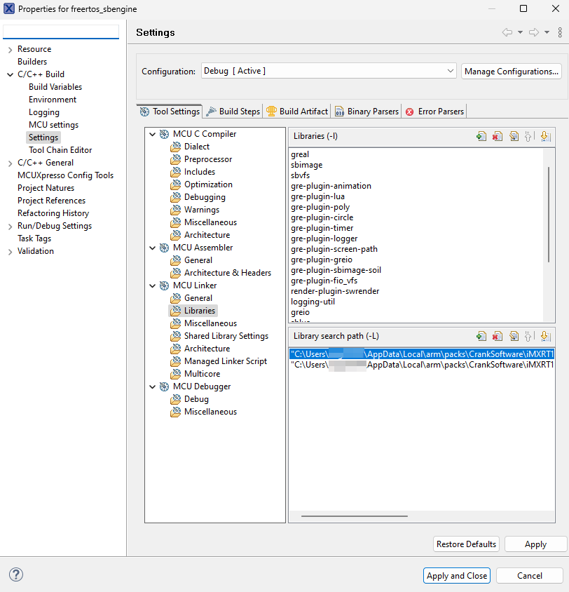

  • Library paths.
Right click on the project and select Properties -> C/C++ Build -> Settings -> MCU Linker -> Libraries.
  1. In the Library Search path (-L) pane add:
    "${cmsis_pack_root}/CrankSoftware/iMXRT10xx/8.1.0/storyboard/runtime/freertos-mcuxpresso-cortexm7-swrender-DFP-obj/lib"
    "${cmsis_pack_root}/CrankSoftware/iMXRT10xx/8.1.0/storyboard/runtime/freertos-mcuxpresso-cortexm7-swrender-DFP-obj/plugins”
    Note: The path will vary depending on where the user saved the pack.
  2. This guide uses the complete configuration of the engine. Therefore, all of the following libraries need to be added in the Libraries pane (-l).
gre
greal
sbimage
sbvfs
gre-plugin-animation
gre-plugin-lua
gre-plugin-poly
gre-plugin-circle
gre-plugin-timer
gre-plugin-logger
gre-plugin-screen-path
gre-plugin-greio
gre-plugin-sbimage-soil
gre-plugin-fio_vfs
render-plugin-swrender
logging-util
greio
sblua
soil
swrmgr
swrender
font-plugin-freetype
sbfreetype
sbpng
sbz
Note: The library order matters. Add the libraries in the order listed above and click Apply and Close

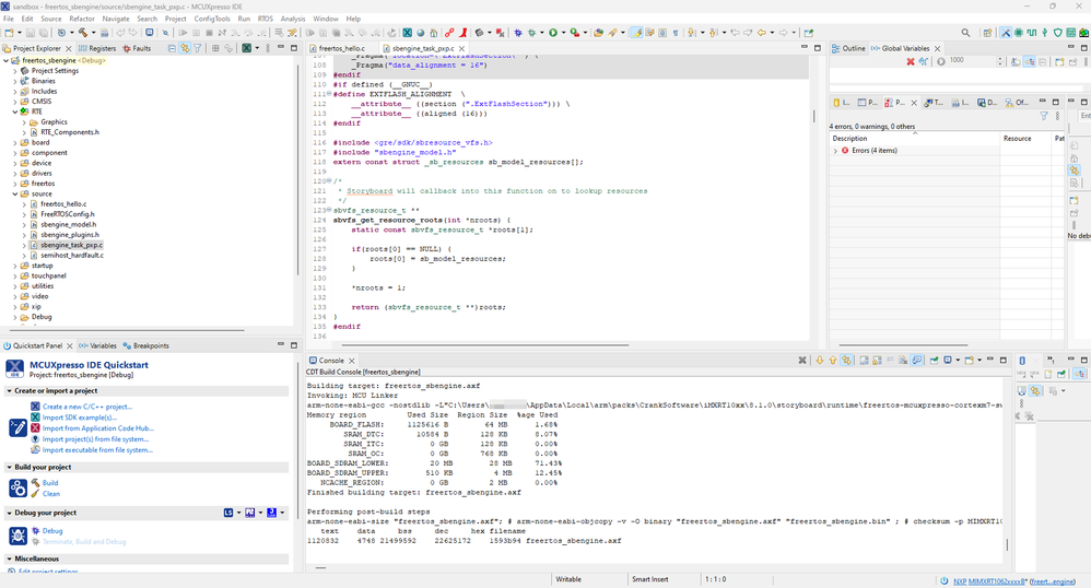

NOTE: Check that the line: #include sbengine_model.h in the sbengine_task_pxp.c  file matches the name of the exported header file from Storyboard.
The project should now build:
