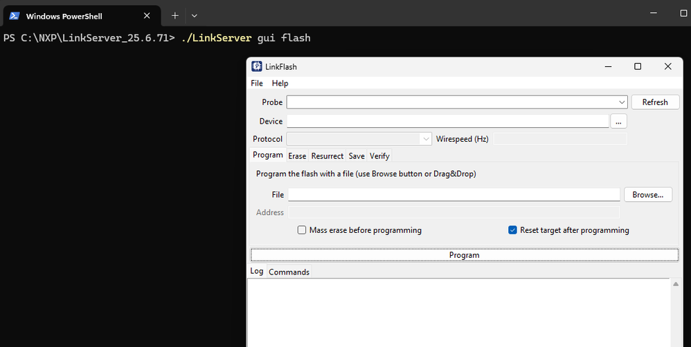

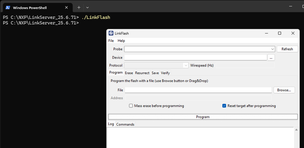

LinkFlash can be launched from the LinkServer directory via terminal using:
./LinkFlash
or
./LinkServer gui flash
It interfaces with LinkServer probes and supports a wide range of NXP devices, offering a visual alternative to command-line flash operations.

The LinkFlash interface is organized into five main sections:
  1. Menu Bar
  2. Probe and Device Options
  3. Flash Commands
  4. Logs
  5. Status Bar
