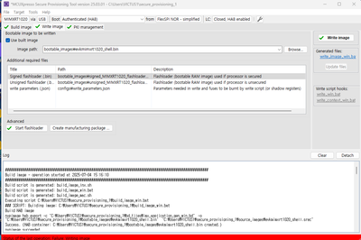

I’ve been using it without any issues until recently, but suddenly, I can no longer write the image.
The USB connection is confirmed to be working, and the DIP switch is set to Serial Download Mode.
What could be the reason it’s not working anymore?
What's even more strange is that I couldn’t figure out what was wrong, so I tested with another board — and the write was successful.
Then I reconnected the original problematic board, and this time the writing succeeded as well.
What could be the cause of this behavior?
Is there something unstable in the current software?
If it fails intermittently like this, what should I do to recover from the failure?
Below is the Log from the Tool window.

ERROR: Script failed with return code: [2]ERROR
### SCRIPT: Writing image: C:\Users\VICTUS1\secure_provisioning_1\write_image_win.bat
### Parse input arguments ###
### Check presence of FlashLoader ###
### Configure FlexSPI NOR memory using options on address 0x2000 ###
blhost -t 5000 -u 0x15A2,0x0073 -j -- fill-memory 0x2000 4 0xC0000007 word
"command": "fill-memory",
"response": [],
"status": {
"description": "0 (0x0) Success.",
"value": 0
blhost succeeded
blhost -t 5000 -u 0x15A2,0x0073 -j -- configure-memory 9 0x2000
"command": "configure-memory",
"response": [],
"status": {
"value": 0
blhost succeeded
### Erase memory before writing image ###
blhost -t 50450 -u 0x15A2,0x0073 -j -- flash-erase-region 0x60000000 45056 0
"command": "flash-erase-region",
"response": [],
"status": {
"description": "20106 (0x4e8a) FlexSPINOR: Command Failure.",
"value": 20106
blhost failed
### RESULT of the script `Writing image`: Failure (return code = [2]ERROR)
Status of the operation: Failure: Writing image

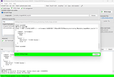

Below  picture is successfull  state.   again...   but I did  nothing...    when fail -> successful

this problems means the memory configuration is not valid or flash cannot be erased. Double check configuration of the external memory.

Seongyon_Jeong
You mean [from "FlexSPI NOR - simplified"], this part?
When I click it, the "Boot Memory Configuration" window pops up.
So you mean I should double-check the memory configuration in this window, right?
2,627 Views
marek-trmac
Yes, this is what I mean.
Background information about flash configuration:
There are two options, how to configure FlexSPI NOR flash. By default, simplified option is selected, this works for most of the flash memories. During flash initialization, ROM converts the simplified configuration into FCB (flash control block), I think it is 256 or 512 bytes block configuration. If you have this block, you can use it directly in SEC.
