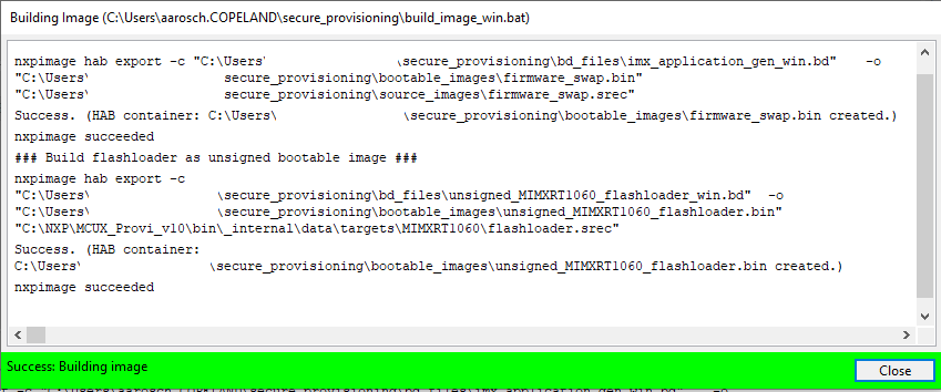

There are no issues with when executing securep.exe -v, but these do not include the script init_flashloader_win.bat
Please see the attached images. I am able to connect and build an image, but I am not able to write the image. I believe this is because the SEC is looking for the init_flashload_win.bat file but its missing.
I have reinstalled the SEC in Administrator mode but the issue still persists.

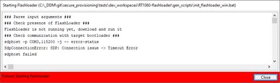

You said init_flashloader script is missing in your workspace, but on the screenshot named "no flashloader edit.png" I can see the script was started and it does some actions (for example Parse arguments). Also during the build I can see the flashloader app itself is prepared to your workspace.
Based on this info, I suppose you have some custom hardware and the flashloader does not start on your hardware. Can you please doublecheck the script and confirm?
I think the init_flashloader contains echo off, so we do not see all details what's executed. May be, you can comment-out the echo off and look at the details.
The log may say that it is "Executing script" and parsing arguments however I am sure there is no script at the location 'secure_provisioning\gen_scripts\init_flashloader_win.bat'. Also, there is an error with return code 2 immediately after this statement. Maybe its possible the log would print that the script is executing even if the file didn't exist?
Yes it is custom hardware. It does look like the flashloader is not starting. I'm able to program the board using MCUXpresso... not sure if this would involve the flashloader or not...
I don't have this file so I can't remove the echo off.

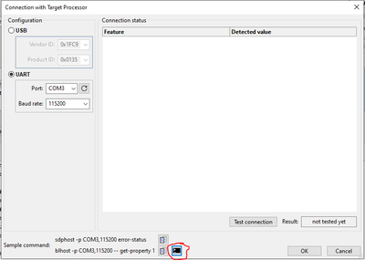

I tried same use case on my computer, and the script is created. You can identify the script the following way: open the workspace, where flashloader failed, and go to "main menu > Target > Connection" and hit the black button on the bottom of the dialog to open terminal
This will start terminal in your workspace. In the terminal run the following commands:
cd gen_scripts

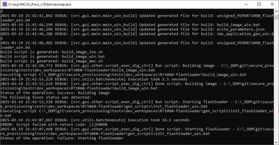

Also, during the write operation, (securep.exe -v), the console contains:
It would be good if you try the same and share the console output AFTER you reproduce the problem. Console content you sent previously contains only build operation, while the log from GUI shows the init_flashloader script was executed.
Also kindly confirm whether you could locate the script in your workspace.
