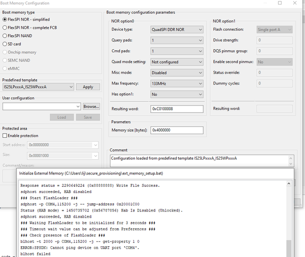

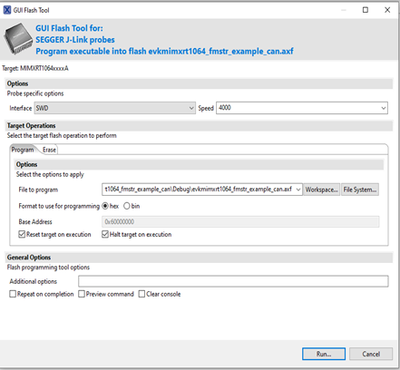

Fig 1 SEC erase memory fails

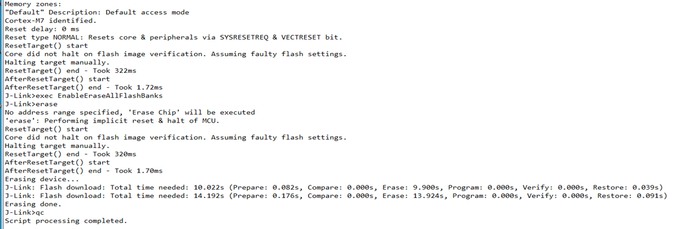

Fig 2 GUI flash tool configuration

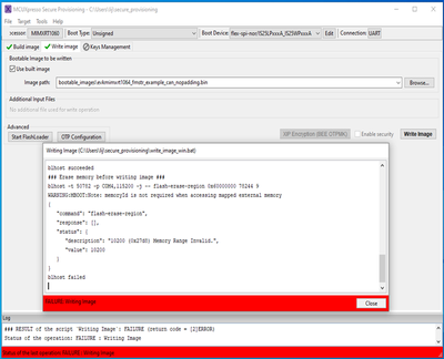

Fig 3 GUI flash erase memory successfully
Try to write image to RT1064 processor with RT1060 profile so that it writes to QSPI NOR memory, but SEC tool V7 configures or erases the flash memory fails shown in Fig 1. So that I try GUI flash tool of JLink to erase all memories, it works shown in Fig 2 and 3, I think this indicates my memory hardware is fine, problem is SEC v7 software configure or erase memory fails, what can I do to make SEC V7 work?

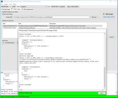

 Try to test memory configuration as follows, but fails as shown in Fig 4 below,

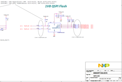

  Here is schematic of RT1064 EVK from NXP and clearly there is additional external flash memory. Why is it existed if it is not supported? This is the same IC in my hardware.

in reference manual RT1064, 07/2021, in chapter 9.6.1.2 I found that processor boots from serial NOR flash attached to FLEXSPI2_A_SS0_B. I have not found information, that it can boot from FlexSPI1. I suppose this was a reason why we have requirement in MCUXpresso Secure Provisioning tool to support SIP flash only.
Definitely, MCUXpresso Secure Provisioning tool is not designed to support all uses cases. We suppose most typical use cases only, that make sense for majority of the customers.
Please mind, we generate script for the configuration, so in case, you need to try any unsupported use case, you can modify the generated code manually and customize it.

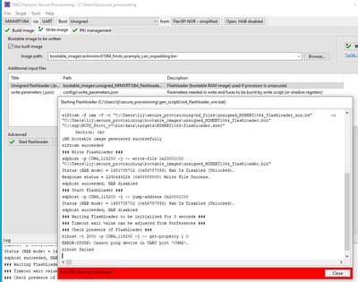

In you log we see, that RT1064 flashloader failed. Can you check this on RT1064 EVK board? We do not see any reason why the flashloader fails.

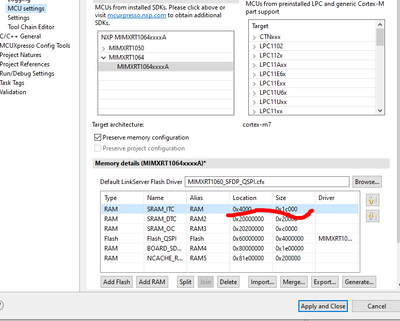

  Many thanks for your help, I successfully programmed the internal flash using 1064 profile by changing source memory configuration as shown below Fig 1, the starting RAM address is 0x4000 (recommended is 0x3000), then the size is 0x1C000. Compile and build image on axf file, then writing image is success in Fig 2.
Fig 1 memory configuration in source code
Fig 2 Writing image success.
 This is surprised to me, why the RAM configuration affect program writing? it may affect power up booting.

do not use RT1060 if you have RT1064. SEC tool already contains valid configuration of the flex-spi nor flash, which is in the SIP for RT1064. Select RT1064 and it must work.
