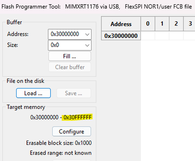

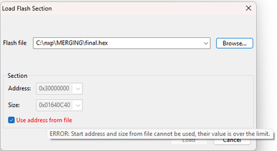

When I try to use this .hex in "Flash Programmer Tool", i have this error:
Looking at the target memory, the size is wrong:

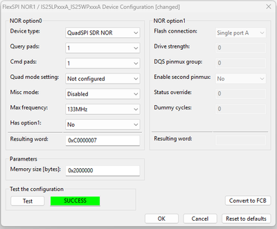

Looking at the configuration of the flash, its seems to be OK (32MB):
Created with this configuration:

marek-trmac
Hi Daniel,
it seems we have limitation in Flash Programmer to maximal size 0x1000000 (16MB).
Have you tried the build & write with the merged image?
Have you tried Additional Images instead of merged image, what I recommended in the previous post?
Marek

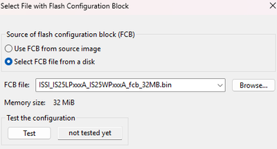

I send you attached the file.
I'm using this converted_fcb, created with simplified with correct memory size (0x2000000)
The test is OK with this fcb:

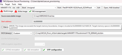

4,952 次查看
daniJVV
With the new version of SPT, and doing the build and write it's working now!
But I need a simple solution for manufacturing.
Can I create a unique file to write?
I saw the manufacturing tool, but I didn't find much information about it.
Thank you very much

liborukropec
Hi @daniJVV ,
I'd add one note - if build & write works for you, then also manufacturing will work, no need to change the workflow just because of manufacturing tool. Just follow the documentation to create a manufacturing package and then import it.
Libor

Hi Daniel,
on the first look the memory configuration size looks good, but not the computed range in the Flash programmer.
1. Can you confirm what version of SEC tool you are using? Looks like you are using quite old version.
2. Could you try if you reproduce in the latest SEC tool 25.03?
Libor
5,017 次查看
daniJVV
Hi Libor,
Thanks for your answer.
Now seems that the size of target memory is correct, but when trying to load the HEX file same error appears:
Any ideas?
Can I perform the same from different approach?
