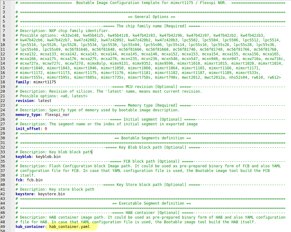

mastupristi
Senior Contributor I
hi @marek-trmac
try "nxpimage bootable-image"
this looks very interesting.
I followed the suggestion in the documentation and tried first
nxpimage bootable-image get-templates -f mimxrt1175 -o outDir
it creates a lot of files, but the one I'm interested in is bootimg_mimxrt1175_flexspi_nor.yaml
There are two questions I'd like to ask:
  1. I don't see any section dedicated to Image_Version, has it been “forgotten” or is it not supported by this command?
  2. At the end there's a reference to the file hab_container.yaml, which I can't find in the spsdk installation though. I also wonder if I should write this file myself but I have no idea how it should be done. Can you give me more detail on this point?
Last thing: If I wanted to write my own python script to do this operation what example could I follow?
best regards
Max

nxf93270
Hi @mastupristi ,
I might bring more light into this topic.
The bootable image command was created exactly for this use case - customer wants to create a bootable image with all the segments before the actual image(such as FCB, keyblob etc) without bothering with looking for segment offsets in NXP documentation.
Regarding your questions:
1. Regarding the information I got today, the image_version should be placed on offset 0x600 in the final bootable image. Unfortunatelly this information is not in our database yet. It will be fixed and released in 2.6.1 release soon.
2. The hab_container configuration setting is the actual HAB image(normally located on the offset 0x1000). It can be either yaml configuration file holding HAB configuration(and SPSDK will generate the binary) or the actual image in binary form. I assume you already have HAB generated, so just reference the file here.
Regarding FCB discussion above. You have several possibilities here. You can configure the memory on the chip using option word and then read the whole 512 bytes segment from the external  flash memory and then use it in the bootable-image configuration
Second option is to generate it "offline":
  1. Generate FCB template with nxpimage bootable-image fcb get-templates
  2. Update the template based on your preference
  3. Export the binary using nxpimage bootable-image fcb export
