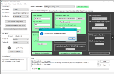

as title , I enable a HAB on RT1010 by MCUXpresso Secure Provisioning Tool ,
If I want to use this board on NXP-MCUBootUtility,
How should I set it up to gain access? Do I need to load PKI data?

Hi Omar,
SEC tool uses open source SPSDK utilities to configure the security on the processor. See https://spsdk.readthedocs.io/en/v2.3.0/usage/applications.html
Marek

Hi Omar,
why do you need to use NXP-MCUBootUtility? Is there anything missing in MCUXpresso Secure Provisioning tool?
Definitely, once the board is HAB enabled, you must use only the original keys used for provisioning.

Hi @marek-trmac
     We plan to port the NXP-MCUBootUtility functionality to the Android platform because it provides open-source code. Therefore, we need to know how to integrate the HAB parameters from the SPT into the MCUBootUtility.

Hi Omar,
Marek
