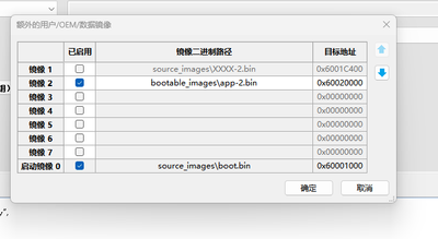

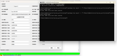

hi:
I refactored app.bin with the command and generated app-2.bin. After burning it in, the code couldn't run. I don't know where the problem lies?
acallamp_0-1733545628336.pngacallamp_0-1733545628336.pngacallamp_1-1733545663027.pngacallamp_1-1733545663027.png

it is not clear what you have exactly did. If you put all into one bee_config.yaml file, then it won't work, because you cannot have multiple input_binary, output_name attributes, only one will be used. It is not an array.
May be either:
  • first encrypt app.bin as it is main application (Source input image on Build tab) and after encryption use it as an additional image,
  • or create a separate BEE YAML  file just for app.bin and create manually in a command line.
Libor
