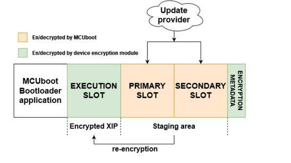

Hi @mastupristi ,
I think the following method should be used for your case, since SNVS master key is provisioned by NXP and only the DCP module inside can access it, so you have to re-encrypt the image by the boot loader.

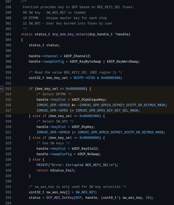

But it is using the SW key as explained in the code (https://github.com/nxp-mcuxpresso/mcuboot/blob/mcux_main/boot/nxp_mcux_sdk/encrypted_xip/src/encrypt...). So I burned 0b10 to BEE_KEY1_SEL fuse to enable OTPMK instead of SW key, leaving bootloader and ota_mcuboot_basic untouched.

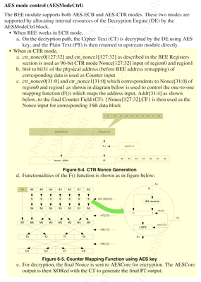

I also thought that the problem might be related to the algorithm for obtaining the counter from the nonce.
In fact, we found conflicting information in the documentation and code. We have always understood that to obtain the counter, the upper 96 bits of the nonce are taken, and the 4-bit shifted address is placed in the lower 32 bits.
This is confirmed by the code (https://github.com/nxp-mcuxpresso/mcuboot/blob/mcux_main/boot/nxp_mcux_sdk/encrypted_xip/src/encrypt...), but also in the documentation:
However, in another part of the documentation, we found this:
I wonder if this algorithm is used exclusively when OTPMK is used.
Otherwise, can you help us understand where we are going wrong?
